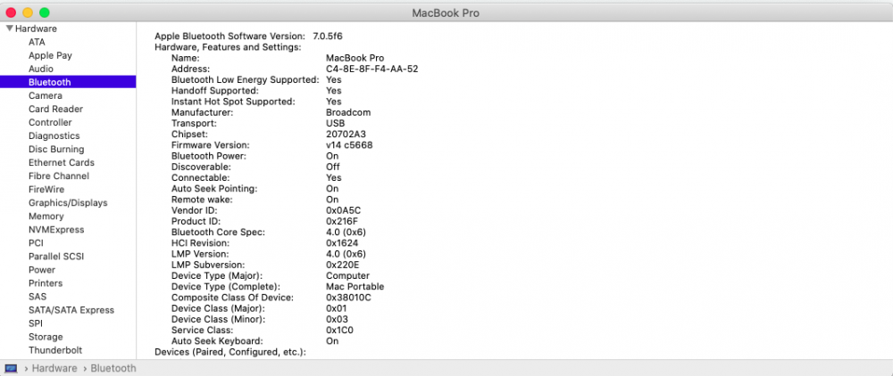

BT:
BCM20702A0:
  Product ID: 0x216f
  Vendor ID: 0x0a5c  (Broadcom Corp.)
  Firmware Version: v14 c5668

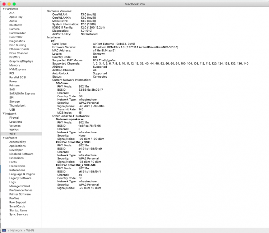

WiFI:
DW1560
  Card Type: AirPort Extreme  (0x14E4, 0x19)

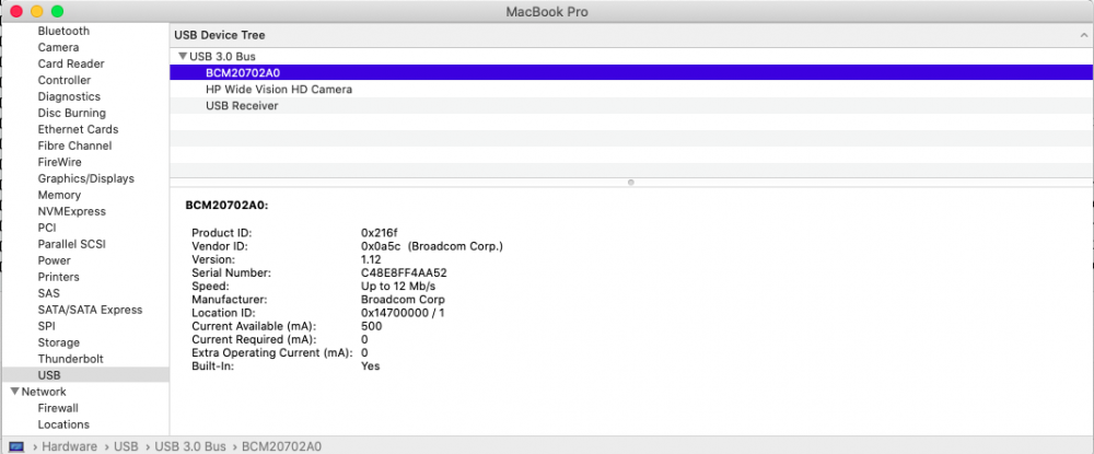

This is running on a HP ce140na laptop with Intel i5-8250U. I have my USBs set up correctly with a SSDT, card is recognized, wifi and bluetooth function "correctly" - I have FaceTime running OK, can place phone calls from the laptop, handoff works, so does AirDrop, however:
1. Bluetooth mouse will occasionally pause for a few seconds - and then "catch up" to my movements, as if it freezes - but where I move and click it buffers and does it all at once afterwards. During this time, touchpad moves OK.
2. Same mouse works very well with its USB dongle (MX Master 3)
3. Apple bluetooth keyboard works, but stutters like the mouse.
4. Sidecar will only work if my tablet is connected via USB-C cable and has wifi disconnected on the tablet.
5. I cannot "import from iPhone or iPad" - it inevitably times out.
6. I cannot join a personal hotspot - even though it is identified - it just fails everytime. (Enabling hotspot manually on the phone and joining manually on the laptop works)
7. iPad and iPhone sync OTA
WiFi works brilliantly and I have no issues with range, signal strength, etc.
