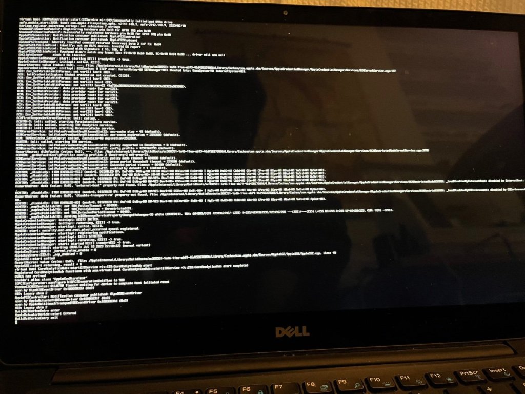

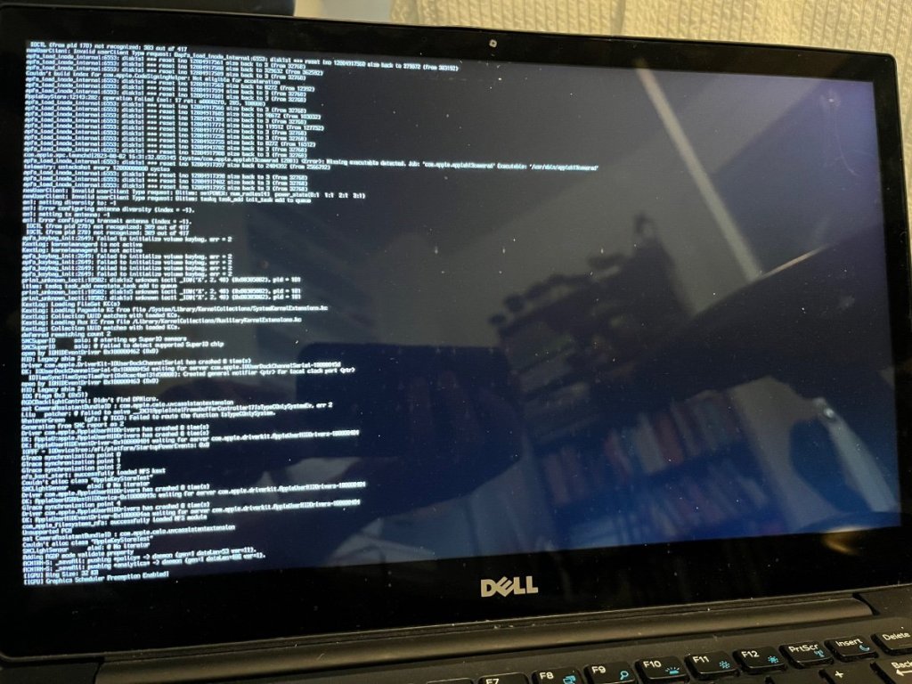

cinoyter Posted August 2, 2023 Share Posted August 2, 2023 Hi again, I have managed to install Ventura on my Latitude 7480. However now I am trying to get the touchpad working and I am having lots of difficulty with ACPI. I have no reason to believe that my touchpad is in any way unusual for this laptop. I dumped my DSDT using a Linux live-USB key distribution (Puppy Linux) and used this to generate a SSDT-GPI0.aml as described. I also have been trying to use the four prebuilt DSDT files for Kaby Lake machines. (This computer is i7 7600U.) A priori, I don't really care which solution is used as long as it works. If I use the four prebuilt DSDT files (but no GPI0) and AlpsHID is not installed, the system boots but there is no trackpad. If I use the prebuilt DSDT files + SSDT-GPIO.aml and AlpsHID + custom VoodooI2C.kext are installed, then I have this screenful followed by a reboot. If I use my own DSDT + SSDT-USBX.aml + SSDT-GPIO.aml and AlpsHID + custom voodooI2C.kext, I have the following screenful and it stays onscreen forever. I am not sure where to go from here. Do you have any idea? Thanks custom_dsdt.zipFetching info... config.plist.zipFetching info... Link to comment Share on other sites More sharing options...
Solution cinoyter Posted August 3, 2023 Author Solution Share Posted August 3, 2023 The problem was that I used the VoodooI2CHID bundled with AlpsHID (as in the AlpsHID instructions), but when I used the VoodooI2CHID bundled with VoodooI2C, the touchpad worked. Link to comment Share on other sites More sharing options...
