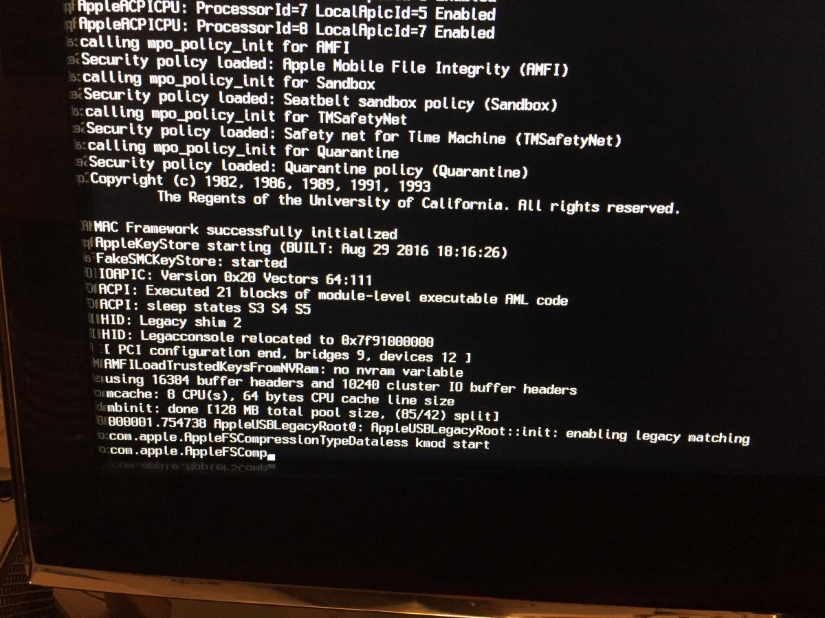

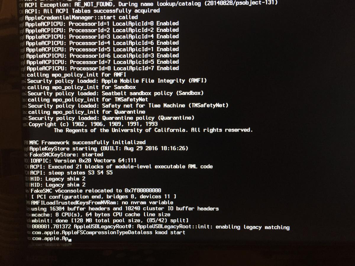

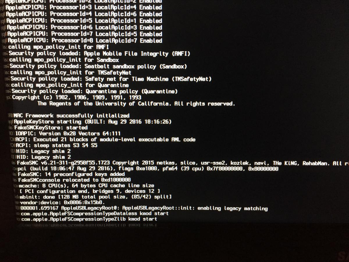

I am just building my first Hackintosh and having problems with starting via clover.
I am always stuck just at the beginning of the progress bar below the apple.
I want to install MacOs Sierra with Clover from an Lexar 128 GB USB drive.
After reading a lot, I tried diverse boot options like "npci=0x2000 nv_disable=1" or "PCIRoot=1". I turned on the safe mode but it still freezes just at the beginning of the progress bar.
I set the bios options, I changed the USB slot of the stick from front to back and since I thought it might be the graphics card, I removed it and changed to internal graphics. But it still freezes at the same point. Sometimes one line more or less but still around the same. I attached some photos of the point it freezes.

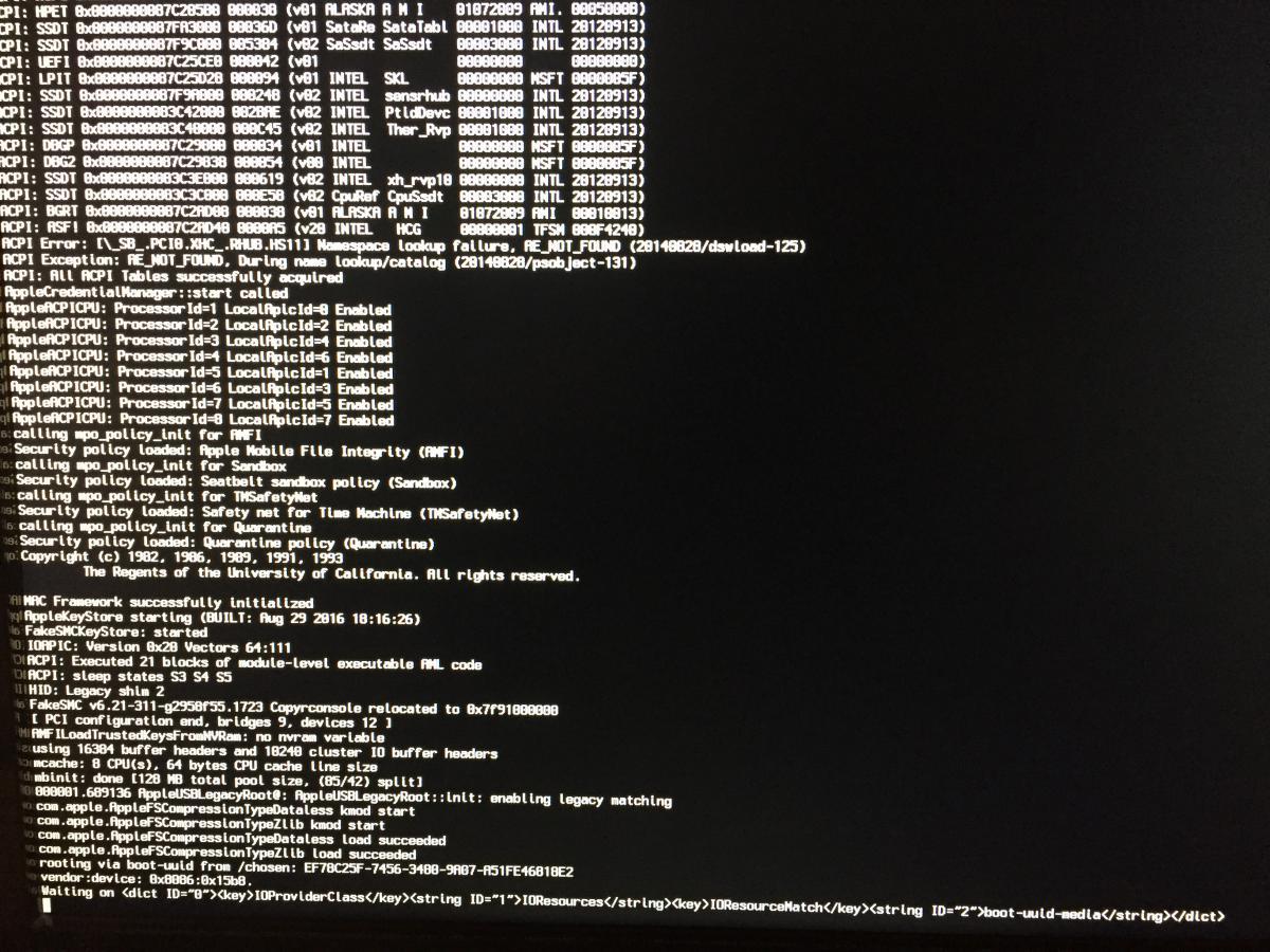

After almost surrendering, I flipped and tried a lot of different Clover options and with these checked, it finally progressed and let me install MacOS Sierra:
- usb ownership
- usb injection
- cpu halt enabler
- graphics injectEDID
Does anyone have an idea what the problem might be?!
