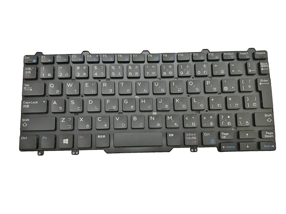

It is a Japanese version of E7450 with Japanese keyboard layout. I attached the layout picture so you can visualize the explanations below.

1) |, ¥, _ key to the left of backspace key: pressing it brings the same results as F3, incrementing the volume.
2) _, \, katakana symbol "ろ" key to the left of the Right Shift key: pressing it is not registered by the system in any way.
I tried running Key Codes to check and maybe reassign them in Karabiner, but pressing them brings no response and displays no key codes.
Could anyone advise how to troubleshoot next and help with it?
