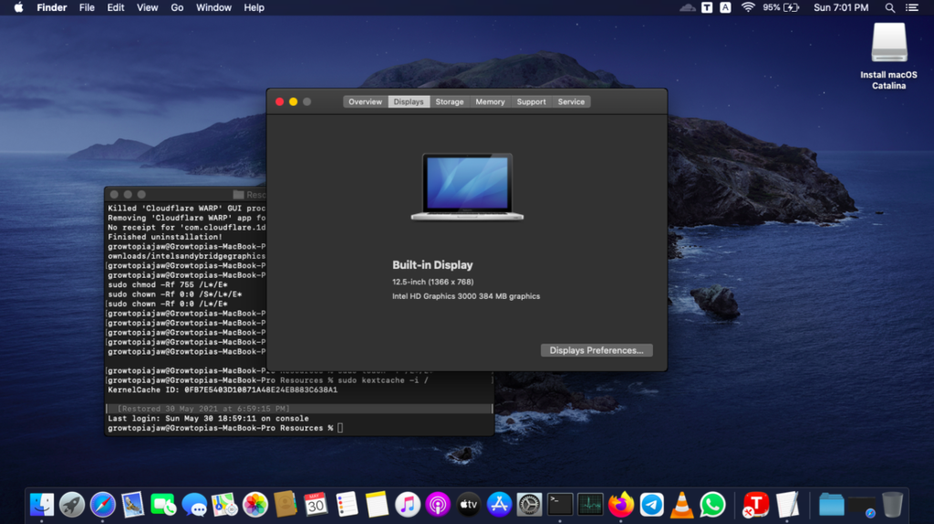

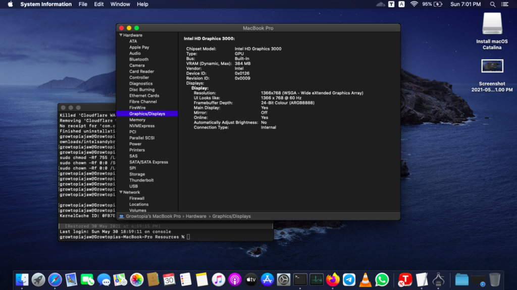

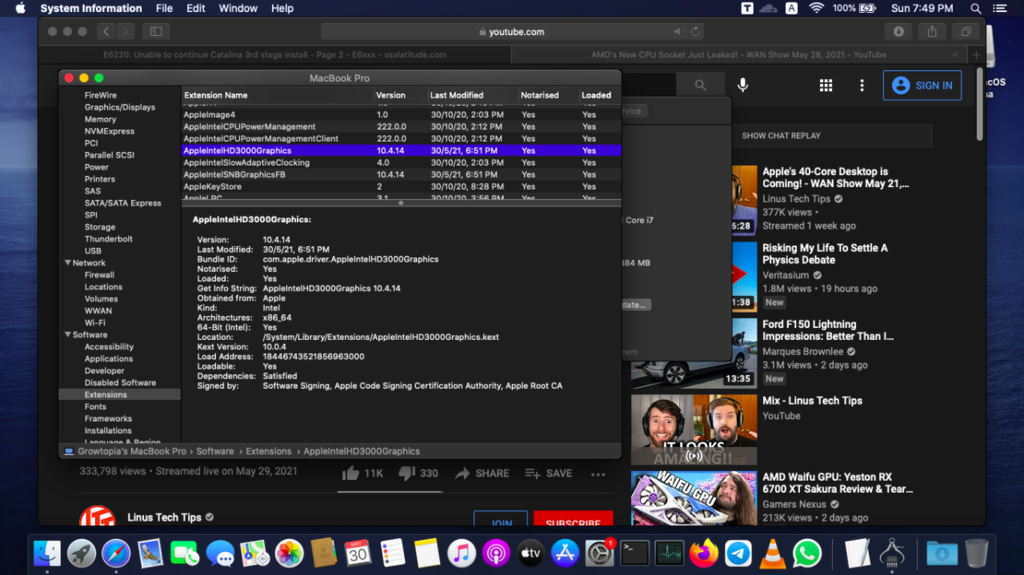

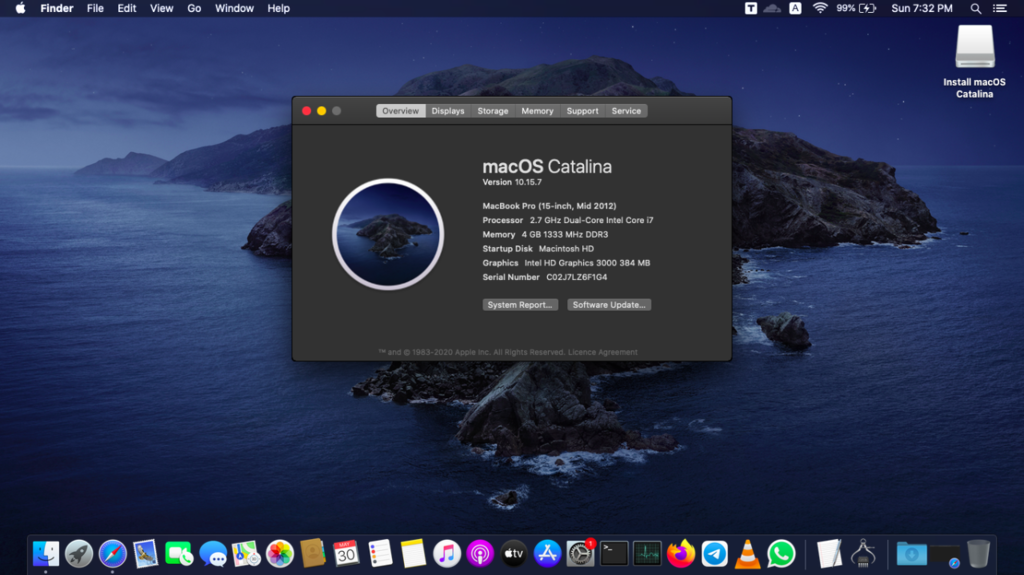

Edit: I've managed to extract dosdude1's Catalina patcher, specifically the "post-install" app. I ran the app manually in the macOS installation environment via the terminal and installed the required fixes using "MacBookPro8,1" as the chosen machine. My SMBIOS in clover is still MacBookPro9,1 but I think that wouldn't make any difference since dosdude1's patcher included a "-no_compat_check" equivalent extension installed in the System. Credit fully goes to dosdude1's amazing app and without his app this wouldn't be possible.
Also, I wanna thanks Hervé for helping me all the way with resolving this issue. Thanks Hervé!
