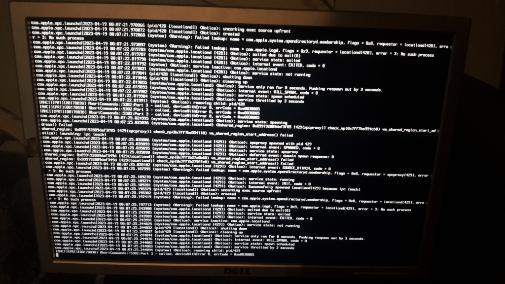

Lost-Entrepreneur439 Posted April 19, 2023 Share Posted April 19, 2023 I got my hands on an Aspire TC-780 recently, trying to hackintosh it on Ventura, it goes into a loop of several lines, the final line of the loop being "AbortCommands : :5382:Port 3 - called, deviceWithError 0, errCode = 0xe0030005". Anyone have any idea on how to fix this? My EFI is attached. EFI.7z Link to comment Share on other sites More sharing options...
Lost-Entrepreneur439 Posted April 20, 2023 Author Share Posted April 20, 2023 (edited) update - managed to fix, i just forgot to put in USBToolbox.kext, but i'm having another problem now. will make another post Edited April 20, 2023 by Lost-Entrepreneur439 mentioned what was causing the problem Link to comment Share on other sites More sharing options...
