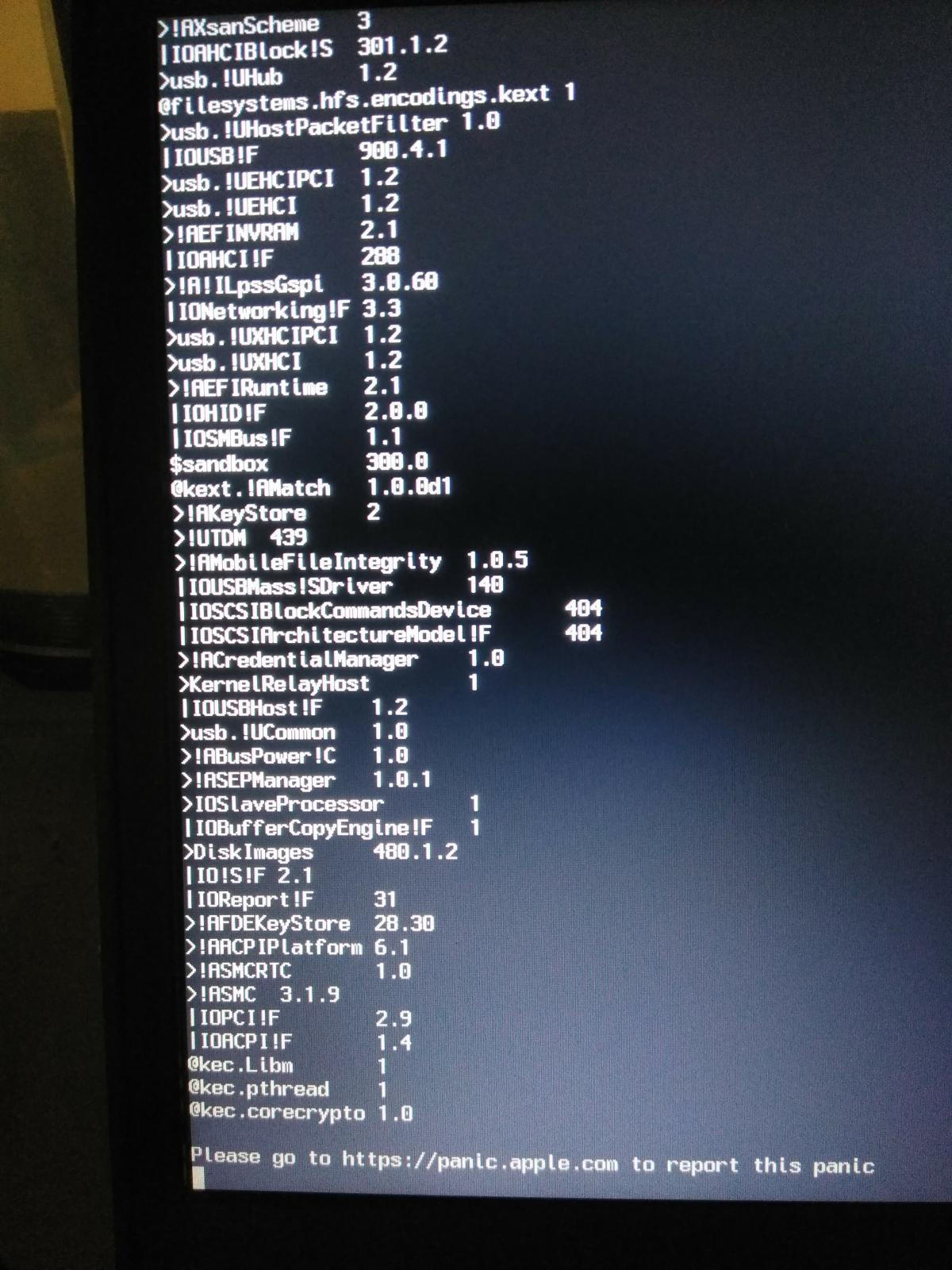

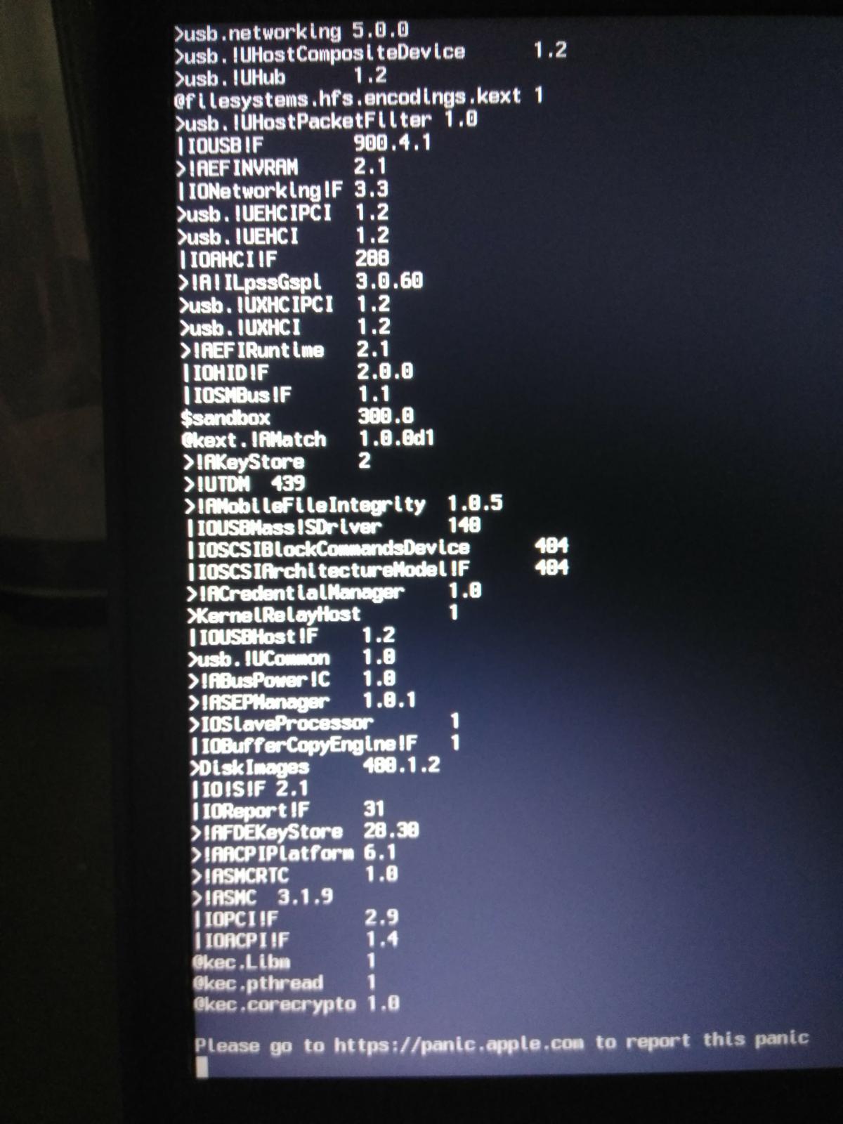

So, this isn't truly Install Help, as I've managed to get the OS installed using the same clover setup and tools/kexts from the Sierra threads. (This is an E5450 with > A15 BIOS and HD5500).
However, when booting the freshly setup High Sierra install WITHOUT using FakeID, I get KPs. I HAVE to use FakeID or it won't boot at all.
Thanks in advance

Launch Config.plist with Clover Configurator (use latest 4.53). Under ACPI, enable FixHeaders_20000000
Under SMBIOS, on the right side, click on the up/down button, select the same model you're using. This will update the SMBIOS and add Firmware Features and Mask. Save and reboot
