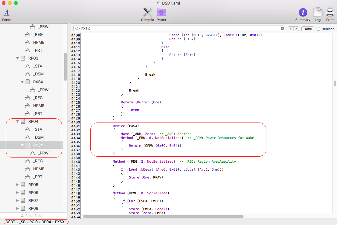

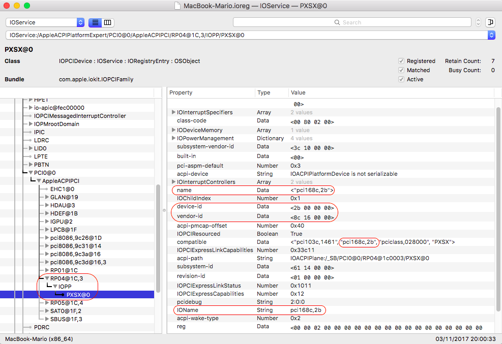

Administrators Hervé Posted November 3, 2017 Administrators Share Posted November 3, 2017 Ok, these are good. So if you look into your IOREG, we see that your AR5B195 card (168c,2b) is attached to PCIe device PXSX, itself under RP04. This is the device to look for in the DSDT for patching. To patch the device, simply insert the DSM method into the device as follows: Device (PXSX) { Name (_ADR, Zero) // _ADR: Address Method (_PRW, 0, NotSerialized) // _PRW: Power Resources for Wake { Return (GPRW (0x69, 0x04)) } Method (_DSM, 4, NotSerialized) // Device Specific Method for the wireless card { Store (Package () { "model", Buffer (0x1E) { "Atheros AR5B195 b/g/n Wireless" }, "device_type", Buffer (0x08) { "AirPort" }, "built-in", Buffer (One) { 0x00 }, "name", Buffer (0x10) { "AirPort Extreme" }, "AAPL,slot-name", Buffer (0x09) { "Internal" }, "compatible", // Declares compatibility with a device Buffer (0x0B) { "pci168c,30" // PCI id of device supported OOB } }, Local0) DTGP (Arg0, Arg1, Arg2, Arg3, RefOf (Local0)) Return (Local0) } } Recompile the DSDT and save the resulting DSDT.aml file for re-use. Please note that the "compatible" statement is what's really required here, the rest is purely cosmetic for the SysProfiler information. I attach the patched table where I also renamed RP04.PXSX to RP04.ARPT. Remember to re-instate the vanilla Atheros kext! Repatched_DSDT.aml.zip 1 Link to comment Share on other sites More sharing options...
