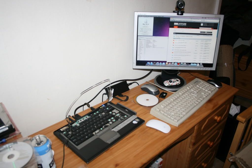

TimST185 Posted February 16, 2012 Author Share Posted February 16, 2012 ......... And an update on the 620 install this evening ........ 10.6.3 via USB stick (I bought 3 new 8GB sticks today so I could do more testing without wrecking previous installs...) Combo update to 10.6.8 - DO NOT RESTART. EDP 1.9.2 (Had a few errors mind - Voodoo Pref pane error was first) and then chameleon wouldnt install on the first try and came back with an error but on the second try (without re-booting) worked and installed ok. Re-booted and had even better sound than my 10.6.3 on my trusty 630 !!! Everything "seems to work" - Magic mouse is working, FrontRow is spot on, wireless connected 1st time and USB mouse works as well....... I have no LID or LCD on this 620 and it's just connected to a monitor running 1650x1080....... but I put it to sleep from the apple menu and it wakes up just fine (Very fast too and way quicker than my 630 currently does) Getting a bit more used to this EDP thing now....... OSX Latitude ROCKS :) BIG HUGE thanks to all the Admin team for this valuable Forum. Whole process from Nothing to USB install made AND OSX 10.6.8 up and running on my 620 - aprox 2 hours not including any downloads as I transferred the 10.6.8 combo update to a spare partition from a spare 2gb memory stick. And the proof as they say is "In the Pudding" ......... Link to comment Share on other sites More sharing options...
Administrators Bronxteck Posted February 16, 2012 Administrators Share Posted February 16, 2012 gee all thats left it to hang it off the back of your monitor to have an iMac... lol Link to comment Share on other sites More sharing options...
TimST185 Posted February 16, 2012 Author Share Posted February 16, 2012 The thought had crossed my mind bronxy I do have a slot loading pioneer drive here that I could fit into it to make it a bit more authentic but the keyboard would need modding as the power button is part of the keyboard It won't hang around long anyhow as I'm working on my 630 again as I type....... Gonna give a Lion install a go if I can get my 630 to 10.6.8 reliably. Link to comment Share on other sites More sharing options...

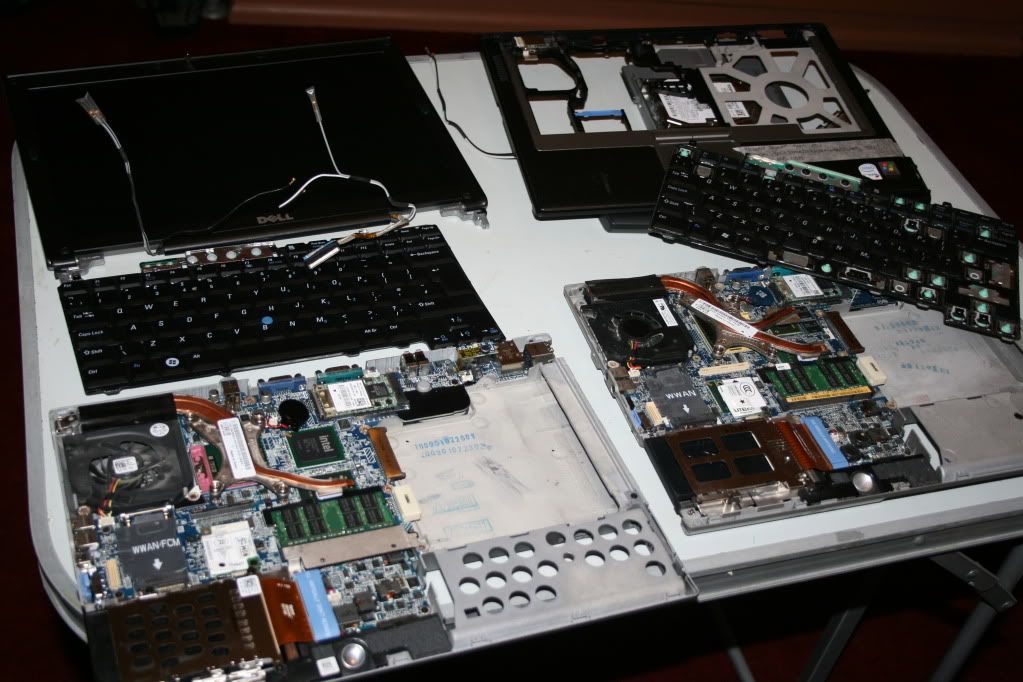

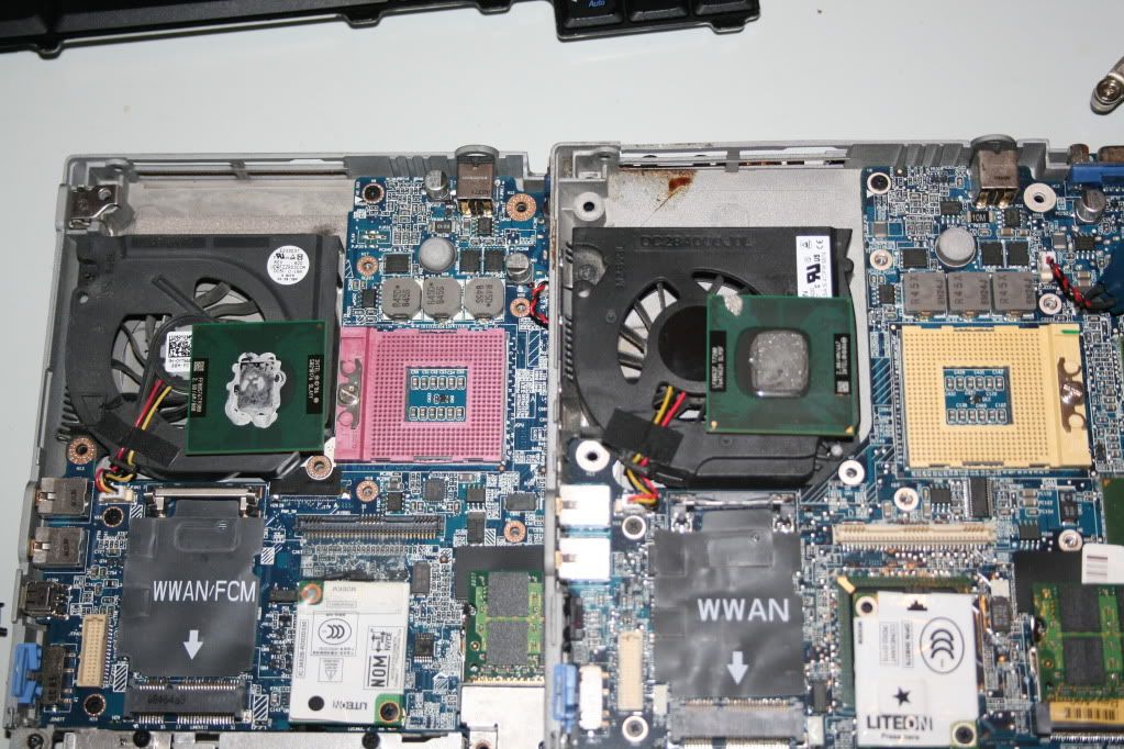

TimST185 Posted February 20, 2012 Author Share Posted February 20, 2012 Update : I gave up trying to get it all working on my 630 with 1440x900 .... The lack of DSDT support means that it's all just not worth the time. In the end, I took the entire lid off my 630 complete with 1440x900 LCD and transferred it onto my 620 Nvidia ..... Booted the 620 with it's installed 10.6.8 and all was normal except with the bonus of 1440x900 resolution as standard and with NON OF THE PROBLEMS that the X3100 chipset presents. NO CHANGING of DSDT's, nothing at all to edit.... Easy as pie Sadly, my 620 can't take my nice 2.5 C2D 6m cache 800 Mhz CPU that my 630 has in it, as it's a different socket....... ..... But, I'm posting this on my 2.0, 4m cache, 667 Mhz 620 which currently out-performs the 630 by miles so I am happy with that. I'd strongly suggest from the last 4 weeks of hard work that 1440x900 D630 owners concider a D620 Nvidia over a D630 Intel. Regards, Tim. Link to comment Share on other sites More sharing options...
n. choe Posted April 7, 2012 Share Posted April 7, 2012 I concur, the D620 was trivial and I was kicking myself at moving from a 620->630. So the 630 may remain linux/windows while the 620 is a wonderful os x box; sleep and everything works. fantastic. both are 1440x900, compounding the problems. i'm not sure if i can find a 1280x800 screen and reapply that to my 630, or if i can find another 620 to use. Link to comment Share on other sites More sharing options...
