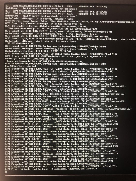

Moderators Jake Lo Posted September 20, 2019 Moderators Share Posted September 20, 2019 At the Clover GUI. press the spaceBar. Select verbose and debug 0x100 mode. Continue booting with new selection Post error where system failed Link to comment Share on other sites More sharing options...
Philu7980 Posted September 20, 2019 Share Posted September 20, 2019 Hi Jake, this is what I have Link to comment Share on other sites More sharing options...
Moderators Jake Lo Posted September 20, 2019 Moderators Share Posted September 20, 2019 Hmm, issue with the SSDT patching. I guess there's more differences from the 3510 and 5510. Boot to Clover GUI, press F4. Remove USB and mount it on a working system. Mount EFI partition, compress and attach /EFI/Clover/ACPI folder here for review and patching Link to comment Share on other sites More sharing options...
