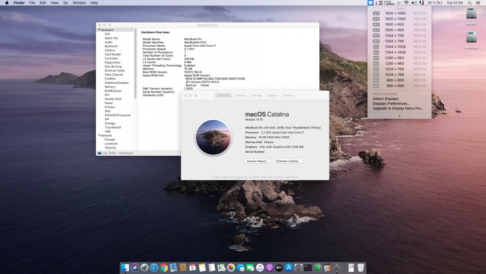

Target macOS release:
  • Mojave 10.14.x
This is a Clover-based installation using the well-known/well documented vanilla method detailed below:
Working:
  • full graphics acceleration on Intel UHD620 iGPU, including brightness control (with Lilu v1.3.5 + WEG v1.2.7)
  • multi-display with HDMI OOB, including HDMI-to-DVI adaptation (HDMI-to-VGA not successful) and VGA/DP over USB Type-C
  • audio, including HDMI, microphone input and headset output (with AppleALC v1.3.6 & layout 11 + CodecCommander v2.7.1)
  • GigEthernet LAN connection (with IntelMausiEthernet 2.4.0 kext)
  • wireless and bluetooth with any compatible card (a DW1820A in my case)
  • left and right USB ports (with Hackintool-generated USBPorts), including USB Type-C
  • integrated webcam (OOB)
  • CPU power management
  • sleep (Lid, Energy Saver settings, Apple menu, Fn-Insert, PWR button) & wake (Lid, PWR button)
  • battery management (with ACPIBatteryManager v1.90.1)
  • keyboard (with VoodooPS2Controller v1.9.2)
  • touchpad (with VoodooI2C v2.1.4 + VoodooI2CHID v1.0), including tap-to-click (mandatory in PrefPane settings), scroll & zoom, rotate or other multi-finger gestures. On occasions, won't work until system is rebooted one or several times.

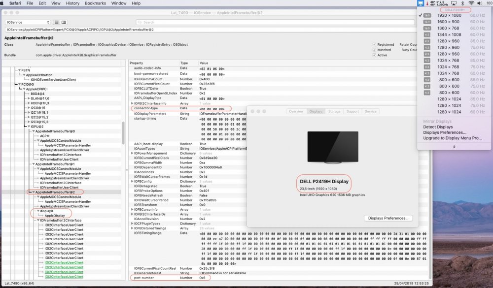

    Fixed an issue of corrupted picture on HDMI output reported here + loss of HDMI audio due to default DP connector type being applied to iGPU FB@1. Fixed with following HDMI properties injection:
    -> included in revised pack #8.

    Working:
    • full graphics acceleration on Intel UHD620 iGPU, including brightness control (with Lilu v1.3.8 + WEG v1.3.2)
    • audio, including HDMI, microphone input and headset output (with AppleALC v1.3.9 & layout 11 + CodecCommander v2.7.1)
    • RTS525a microSD card reader (Performance limited to 5MB/s)
