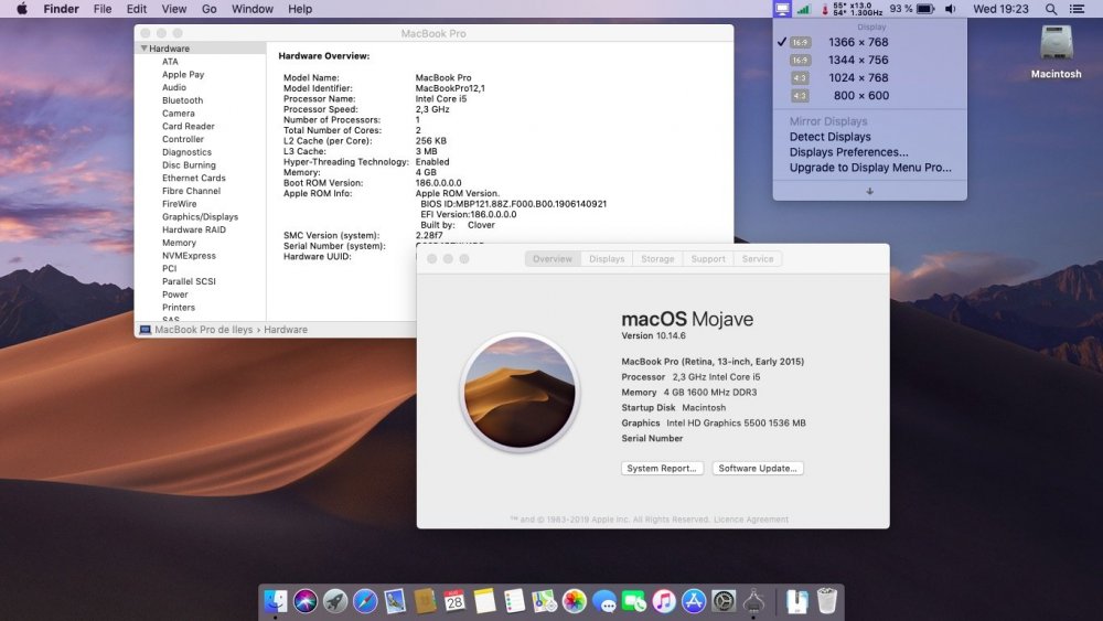

    Target macOS release:
    • Mojave 10.14.x
    This is a Clover-based installation using the well-known/well documented vanilla method detailed below:
    Working:
    • full graphics acceleration on Intel HD5500 graphics (with Lilu + WEG)
    • multi-display with DP and HDMI OOB
    • audio, including jack microphone input and headset output (with AppleALC & layout-id 11 + CodecCommander)
    • HDMI audio (with BDW Framebuffer patch)
    • built-in GigEthernet LAN connection (with IntelMausiEthernet kext)
    • wireless and bluetooth with any compatible card/USB dongle
    • integrated webcam (OOB)
    • full CPU power management, including Turbo boost to 2.9GHz (with CPU-specific generated SSDT)
    • sleep (Lid, Energy Saver settings, Apple menu, Fn-F1, PWR button) & wake (Lid, PWR button)
    • battery management (with ACPIBatteryManager )
    • SD card reader (with DSDT patch for compatibility with Apple's default Broadcom device 14e4:16bc)
    • keyboard (with Dr Hurt's VoodooPS2Controller R6 + DSDT patch for brightness control)
    • keyboard backlight OOB (for backlit models)
    • touchpad including tap-to-click (with Dr Hurt's VoodooPS2Controller R6)
    • USB3.0 ports (with Rehabman's USBInjectAll + FakePCIID kexts for multiplexing)
    Not working:
    • N/A
    Not tested:
    • SmartCard reader
    • fingerprint scanner
    GeekBench v2.4.4 (32bit) gives a 6600+ rating:
