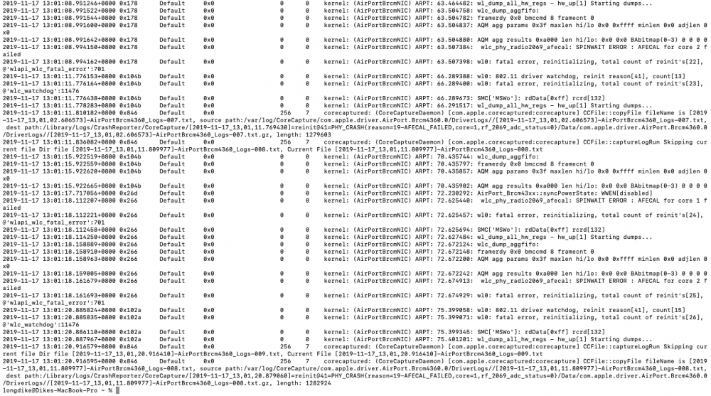

LonGDikE Posted November 15, 2019 Author Share Posted November 15, 2019 1.There is a option to disable WLAN in BIOS in my laptop, but after it is disabled, the system will not recognize the hardware 2.I've removed all the BRCM* related kext, and also removed the BRCM related in the boot parameter of config.list, but it still doesn't work, is there any debug suggestions? thx a lot Link to comment Share on other sites More sharing options...

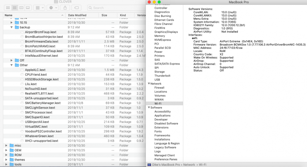

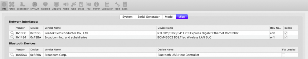

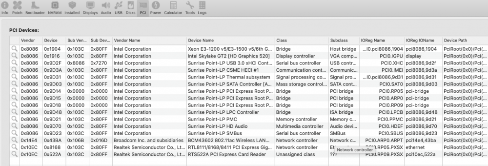

Administrators Hervé Posted November 15, 2019 Administrators Share Posted November 15, 2019 Ok, well now I can see that your card shows its default Locale and Country Code which is why you would have used AirPortBrcmFixup to change those 2 x parameters. What strikes me though is that I still do not see any wireless channels listed at all. Did you check the antenna connections? How many antennas did you connect? All 4? Also, what are the wireless PCI ids and Bluetooth PCI ids shown in IOReg? I beginning to wonder if you would not just have one of those fake BCM94360CD that are known to be sold from a certain eastern location... Link to comment Share on other sites More sharing options...

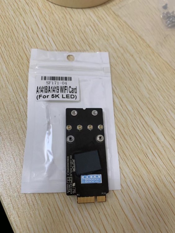

LonGDikE Posted November 15, 2019 Author Share Posted November 15, 2019 It doesn't look fake... I've tried all sorts of antenna connections, and it doesn't seem to work. The card isn't on laptop right now. I'll see if I can provide more information tomorrow. Link to comment Share on other sites More sharing options...
LonGDikE Posted November 17, 2019 Author Share Posted November 17, 2019 I can only provide the following information. Maybe I bought a fake card or a problem card. I'm going to return it tomorrow. Thank you very much for your support. Link to comment Share on other sites More sharing options...
