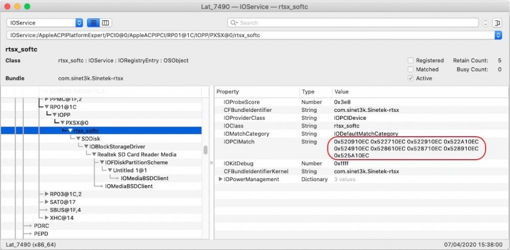

Administrators Hervé Posted April 7, 2020 Administrators Share Posted April 7, 2020 There is renewed development on the matter of Realtek's RTS52xx SD card reader building on Sinetek's initial work : https://www.insanelymac.com/forum/topic/321080-sineteks-driver-for-realtek-rtsx-sdhc-card-readers/?do=findComment&comment=2713476 https://github.com/cholonam/Sinetek-rtsx I've tried out Cholonam's Sinetek-rtsx kext v1.0 on my Latitude 7490 and it's now possible to read (and only read) an SD card once inserted in the reader. It can be ejected and re-inserted at will; it's just a little slow to mount (~10s) and Read-Only. Works after wake too. Supported models appear to include: RTS5209 / RTS5227 / RTS5229 /RTS522a / RTS5249 / RTS5286 / RTS5287 / RTS5289 / RTS525a 1 1 Link to comment Share on other sites More sharing options...
