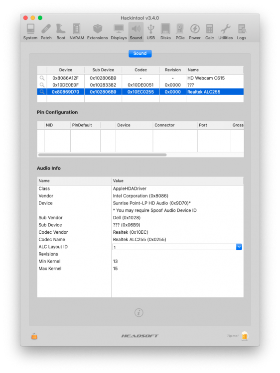

punjabigator Posted May 23, 2020 Share Posted May 23, 2020 Sounds Issue 7040 SFF Realtek ALC255 (0x0255): From the past few weeks I am unable to fix the sound issues. Clover, Lilu and ALC etc are up to date. Looking at the Hackigtnool (HT) ALC Layout ID stuck at 1. I have changed in clover many times under the Device Properties, but Hackingtool still shows 1. Can someone please suggest a troubleshoot as I am out of ideas now? The issue remains Whether I boot Mojave or Catalina (10.5.4) Things I have tried below: 1. Made a new audio patches using HT with different layout options (acceptable) 2. Boot with Kext Inject and without (detect) as well I have attached my config (SMBIOS info scrubbed) and screen shot of HT config 2.plist.zipFetching info... Edit: Injecting alcid=13 as a boot argument has solved the issue. 1 1 Link to comment Share on other sites More sharing options...
