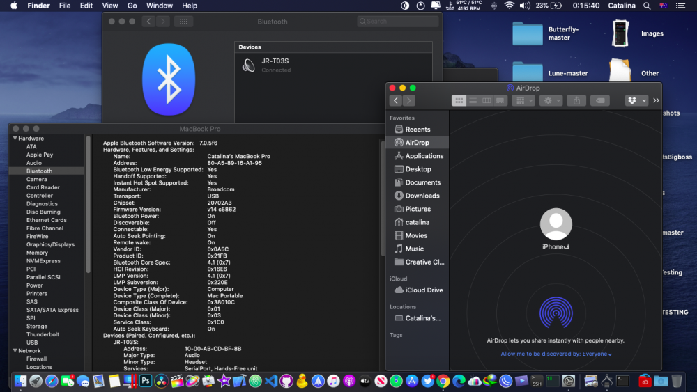

ghaffari Posted May 30, 2020 Author Share Posted May 30, 2020 hi again sorry for this my BT is discoverable by other devices but not discovering any devices ? even i can send via AirDrop easily ! but not discovering other device to send ? thank U> Link to comment Share on other sites More sharing options...

ghaffari Posted May 30, 2020 Author Share Posted May 30, 2020 it's ok thank u so much i see the article really but the BT already not discovering any device not just the AirPods i have other devices also discoverabale on my iPhone But in the hackintosh not ?! Link to comment Share on other sites More sharing options...
arsradu Posted May 30, 2020 Share Posted May 30, 2020 @ghaffari Indeed, you have a valid point... I don't know why they wouldn't show up in this case... What I found intriguing is the fact that AirDrop seems to work... At least from the iPhone to the Hack. Which would suggest that BT itself is working fine. Why it's not showing devices...that I don't know. Kinda weird, indeed... Link to comment Share on other sites More sharing options...
ghaffari Posted May 30, 2020 Author Share Posted May 30, 2020 ye really is weird that's i not understand it ? Link to comment Share on other sites More sharing options...
