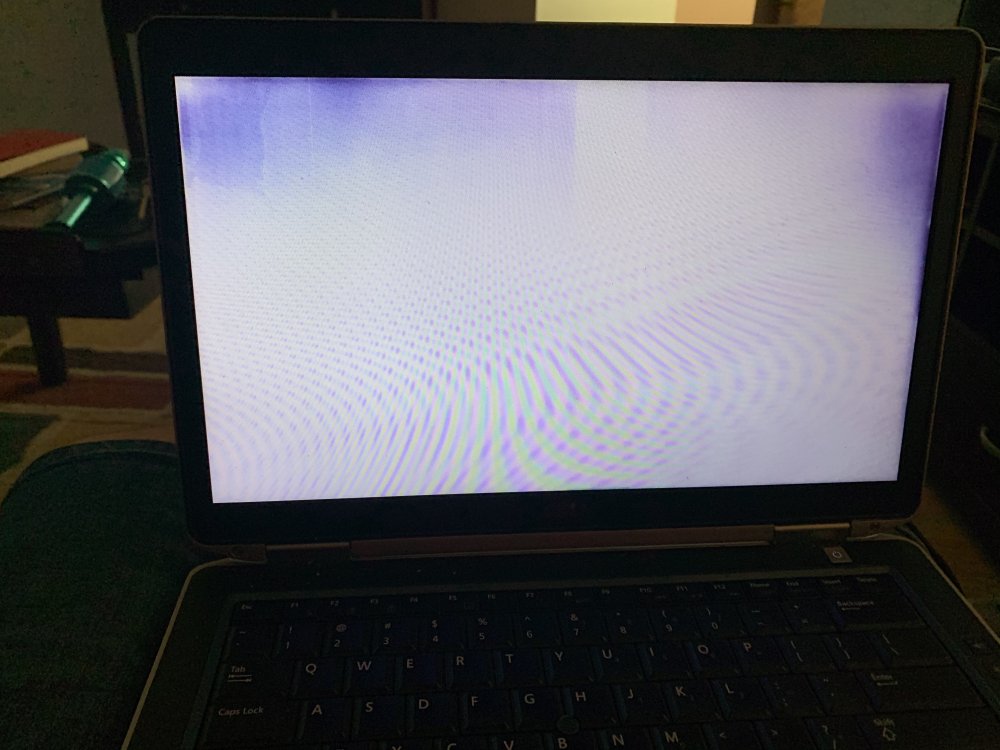

Johnnyquickfix Posted October 15, 2020 Author Share Posted October 15, 2020 It booted all the way to the graphics loader, then I got this screen. If memory serves, this has something to do with the frame buffer but I'm not sure how to change it in OpenCore. Should I post my clover config? Would that help? Link to comment Share on other sites More sharing options...
Moderators Jake Lo Posted October 15, 2020 Moderators Share Posted October 15, 2020 What's the display resolution? What version of BIOS are you on? Link to comment Share on other sites More sharing options...
therealsquirrelman Posted October 16, 2020 Share Posted October 16, 2020 1366x768, Bios A16. the E6430s is essentially an E6330 with a bigger screen. I’ve also used E6430u boot folders in the past. I’d modify myself but I have no idea what I’m doing in opencore and clover doesn’t work right. I can boot in clover, but have no touchpad or keyboard no matter what kexts I use. Link to comment Share on other sites More sharing options...
Moderators Jake Lo Posted October 16, 2020 Moderators Share Posted October 16, 2020 Here, replace these 2 files. It configure for lower resolution. Clover would be easier to configure. Not sure what you did for touchpad / keyboard to not work. You need an Alps touchpad kext by Dr. Hurt which can be found here in our forum. If it still doesn't work right, then you'll need to export you vanilla ACPI files, I'll patch it for you. Since you still have Clover, it's easy to export. Just boot to Clover and press F4. It'll be exported to /EFI/Clover/ACPI/Origin. Compress that folder and attach it here. E6430_lowRes.zip Link to comment Share on other sites More sharing options...
