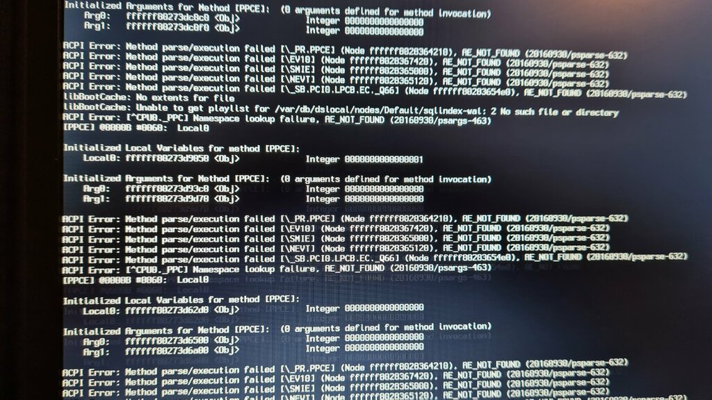

Killery Posted December 15, 2020 Share Posted December 15, 2020 Hello, last Saturday, I asked for your help and Thanks to Jake Lo and Hervé I was able to successfully install mac os Catalina on my Latitude e5440 (thank you very much!) Today I ask for your help again to help me finish the configuration of my Dell, indeed I have several things that are not working or badly: 3.0 USB ports (mac os say that the peripherals I plug into them don't have enough power) Screen resolution Click with the trackpad and multi touch Airdrop For the USB ports I understood that it worked with SSDT / ACPI but I do not know how it works If someone could enlighten me on all these points I would take his advice with great pleasure! thank you in advance K.L EFI copie 2.zip Link to comment Share on other sites More sharing options...

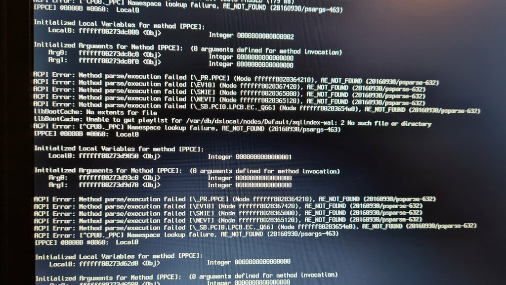

Killery Posted December 17, 2020 Author Share Posted December 17, 2020 Thank you very much it is much more precise with this kext! I didn't know we could open these kext files regarding ACPI errors it is this type of error that I get repeatedly Link to comment Share on other sites More sharing options...
Moderators Jake Lo Posted December 17, 2020 Moderators Share Posted December 17, 2020 try disabling serial port in the BIOS Link to comment Share on other sites More sharing options...
