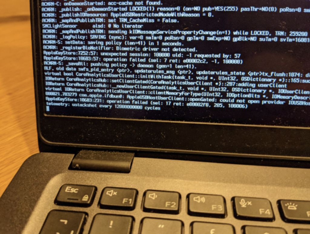

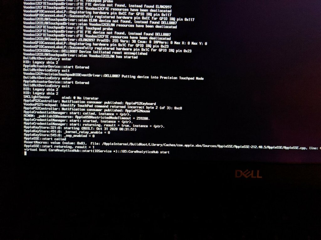

mefflecakes Posted December 16, 2020 Share Posted December 16, 2020 I updated to OC 6.4 on my latitude 5300 last night and all appeared to be working well, checked after a reboot and was happy so went to bed. This morning, it's either taking quite a while or hanging on boot, sitting on the point shown in the attached image. Happy to attach the efi if needed but is there anything obvious in the picture? Just rebooted and got this instead, but it did boot.. Link to comment Share on other sites More sharing options...
Moderators Jake Lo Posted December 22, 2020 Moderators Share Posted December 22, 2020 Have you tried resetting NVRam? You have too many I2C kexts. Your system has an Alps I2C touchpad it seems...so just need VoodooI2C and VoodooI2CHID Link to comment Share on other sites More sharing options...
