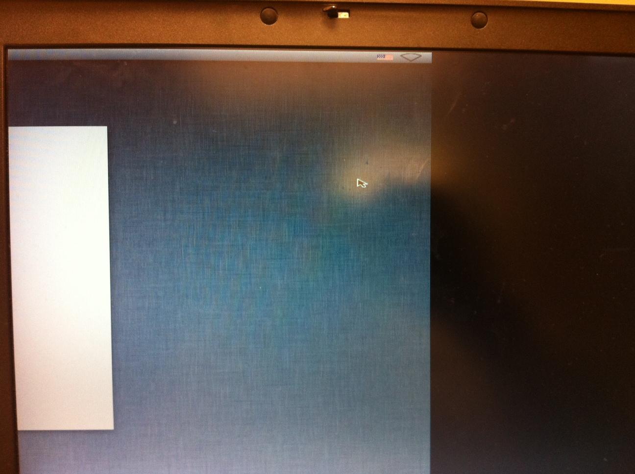

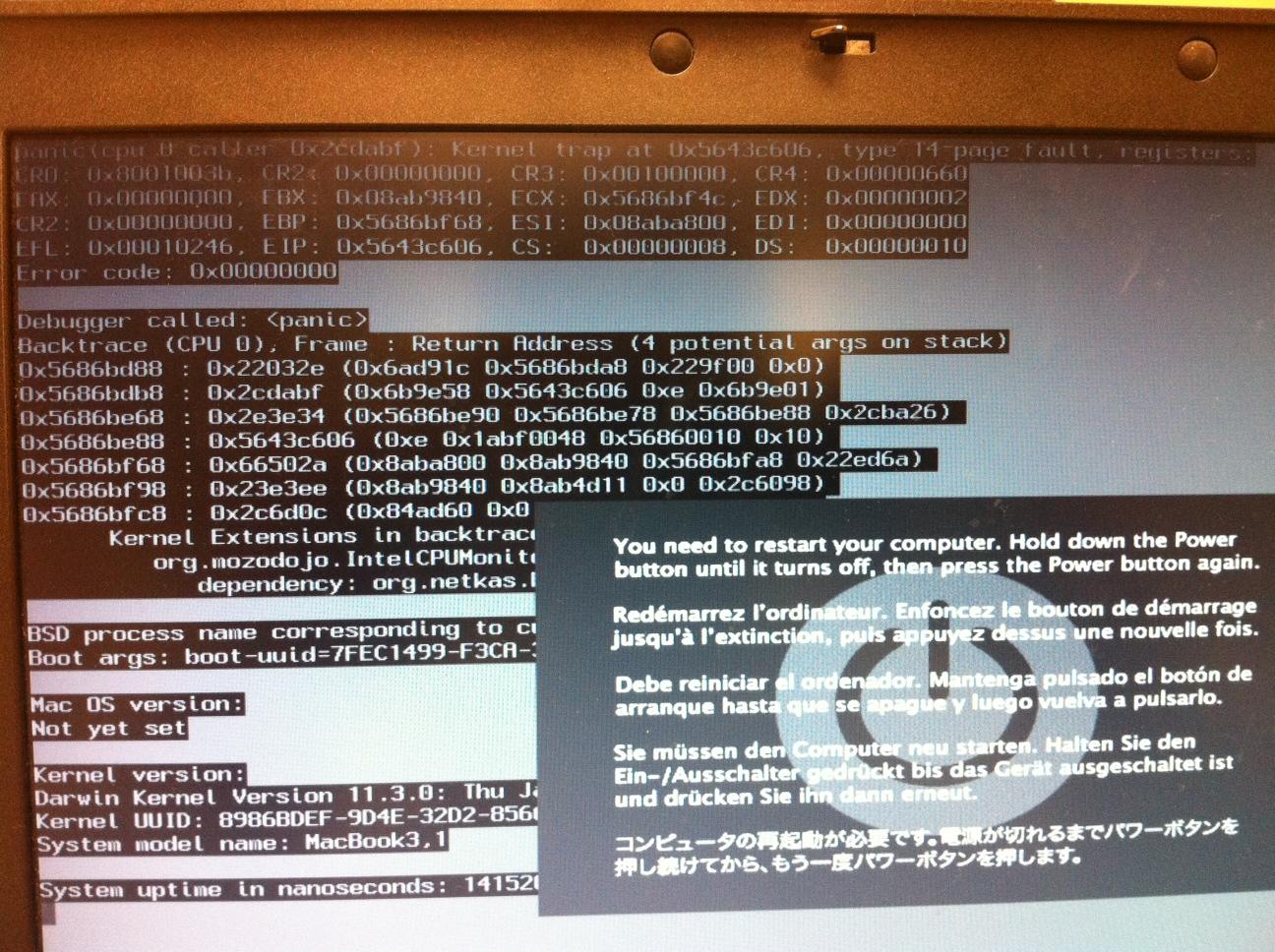

jacqkeen Posted June 26, 2012 Share Posted June 26, 2012 I have a d630 with intel graphics, 4gb ram, 1440x900 lcd, 1395 wifi card. I flashed with the custom bios. I have wifi disabled in the bios and get the kernel panic in the attached picture when booting from usb drive created by myhack on an Intel MacMini (I replaced the Extras folder with the custom one from this site). Any suggestions would be greatly appreciated. Link to comment Share on other sites More sharing options...
Administrators Leon Posted June 26, 2012 Administrators Share Posted June 26, 2012 did you use a bootpack from the sites ? http://www.osxlatitude.com/edp/bootpack/ Link to comment Share on other sites More sharing options...
jacqkeen Posted June 26, 2012 Author Share Posted June 26, 2012 Yes, I used the Dell Latitude D630-intel bootpack. Link to comment Share on other sites More sharing options...
Administrators Leon Posted June 26, 2012 Administrators Share Posted June 26, 2012 Bug found, bug fixed. Download a new bootpack and try again Link to comment Share on other sites More sharing options...

jacqkeen Posted June 26, 2012 Author Share Posted June 26, 2012 Ok, no kernel panic now. However, the display is out of whack when it gets to the installer page. Please see attached. What do i need to fix this? (i am guessing this is because the screen is 1440x900) Link to comment Share on other sites More sharing options...
JawhnL5 Posted June 26, 2012 Share Posted June 26, 2012 OK, go to Dell's website and get the BIOS revision for our D630, put it on a USB stick with UNetbootin and flash your BIOS back to Dell's official BIOS and try again. The problem is when you flashed your BIOS with OS X BIOS you used the low res one so now your screen is going out of whack Link to comment Share on other sites More sharing options...
Administrators Leon Posted June 26, 2012 Administrators Share Posted June 26, 2012 You need the high resolution DSDT for your model.. there should be one on the forum somewhere... Link to comment Share on other sites More sharing options...

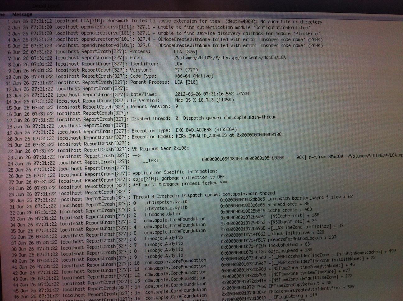

jacqkeen Posted June 26, 2012 Author Share Posted June 26, 2012 I got the high resolution DSDT by searching the forum. It corrected the video issue. I was able to run disk utility and partition the hard drive for the Mac OS. I select the drive to install to, click next and then the screen goes grey and the installer says it cannot continue and gives a HUGE installer log. I haven't been able to save the text but took one picture of the screen. Is my myhack installer borked and needs to be redone? Or is there something else going on? Link to comment Share on other sites More sharing options...
JawhnL5 Posted June 26, 2012 Share Posted June 26, 2012 Here is the high resolution DSDT. This is for the Dell Latitude D630 with the Intel graphics and 1440x900 screen resolution. Replace the DSDT.aml in your Extra folder on your boot USB with the DSDT.aml in this zip file. Cheers! 1440x900_dsdt.aml.zip Link to comment Share on other sites More sharing options...
