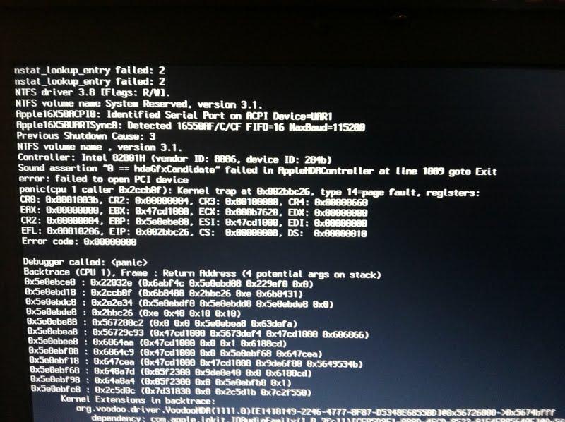

Axis1968 Posted June 27, 2012 Share Posted June 27, 2012 I am in the same boat. This is how far I get. Any help will be appreciated. Am I susposed to run myFix on the usb device after I copy the Extra folder to the usb device? Link to comment Share on other sites More sharing options...
JawhnL5 Posted June 27, 2012 Share Posted June 27, 2012 I am in the same boat. This is how far I get. Any help will be appreciated. Am I susposed to run myFix on the usb device after I copy the Extra folder to the usb device? Have you tried booting -x or pmVersion=0? Also try running a myFix Full mode on the USB stick if those fail. Link to comment Share on other sites More sharing options...
Administrators Hervé Posted June 27, 2012 Administrators Share Posted June 27, 2012 If Snow Leopard is the target, why don't you try using ModCD (or ModUSB if installing from USB key) to see if you encounter the same issue? My experience is that ModCD/ModUSB gets you to initial installation completion without the need of a bootpack but a few actions are required before 1st reboot: 1) copy of DSDT file to /Extra (absolutely mandatory on Intel 1440x900 D630, otherwise black screen at reboot and external screen required) 2) install/run EDP to install model-specific kexts + latest Chameleon bootloader That normally gets to a "basic" bootable system. Updates can then be installed as required (but remember to re-run EDP after installation of 10.6.8 combo update). Link to comment Share on other sites More sharing options...
