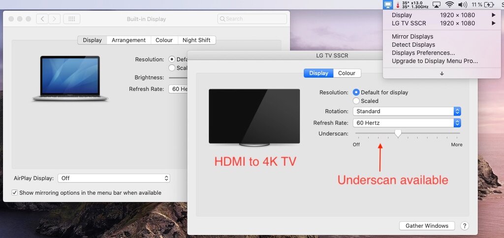

For proper 4K output, patching BIOS to set DVMT pre-allocated memory to 64MB or 96MB is mandatory. Boot a USB key with ModGrubShell installed on it as explained here and set variable 0x432 to 0x02 or 0x3:
setup_var 0x432 0x3
exit
Default value is 0x1 for 32MB (0x2 is 64MB, 0x03 is 96MB). Once the change is applied, no need to inject patched Framebuffer memory settings (fbmem/stolenmem) as properties in your bootloader's config.
Bear in mind that this DVMT adjustment can be removed by resetting BIOS to default settings.

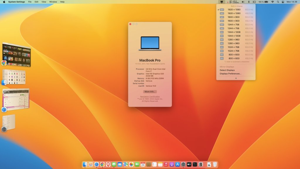

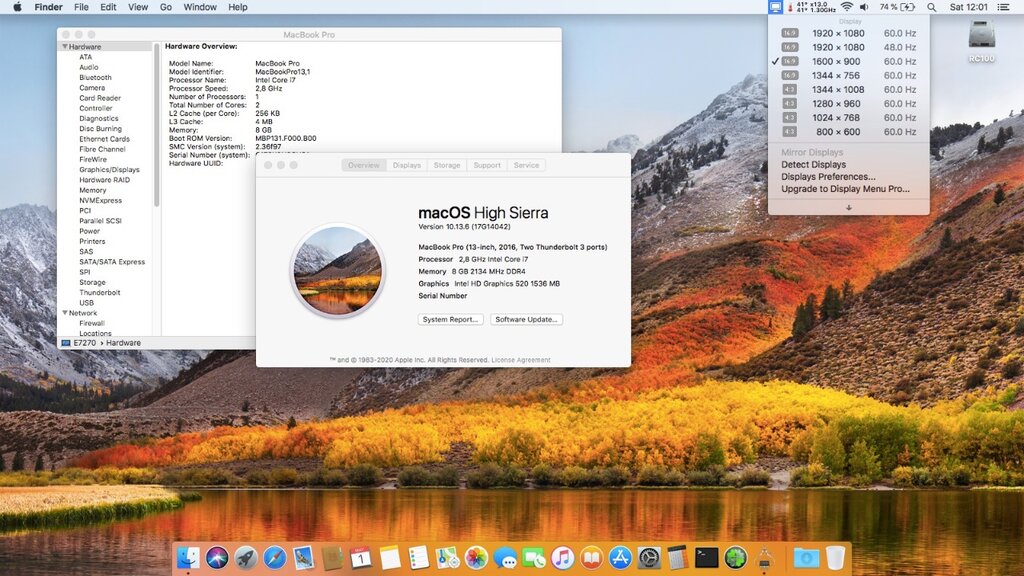

Target macOS release:
  • High Sierra 10.13.x
This is a Clover-based installation using the well-known/well-documented vanilla manual method detailed below:
Working:

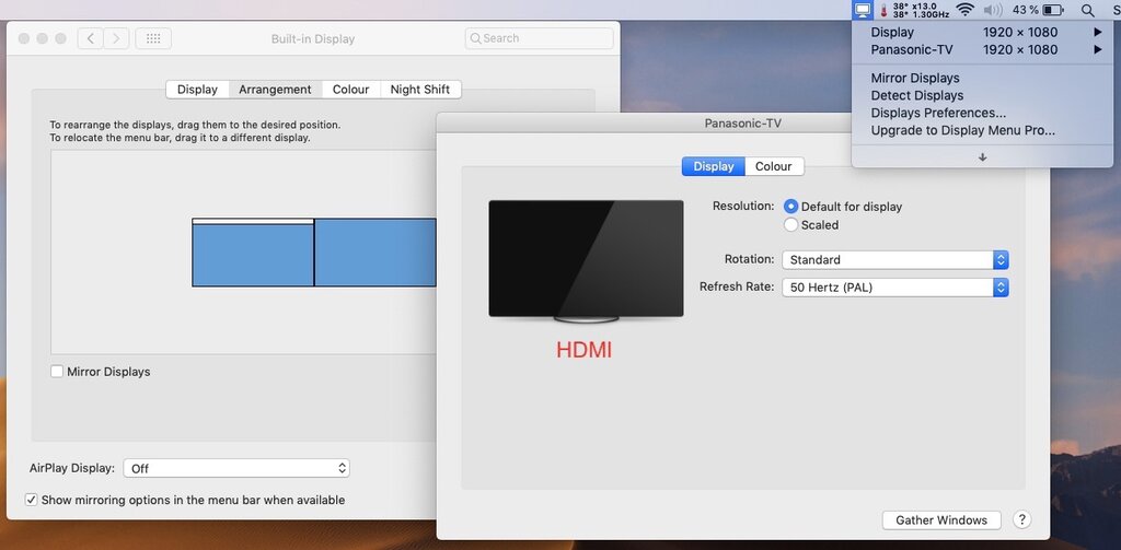

  • full QE/CI with HD520 graphics (with SKL layout 0x19160000)
  • HDMI output OOB but built-in LCD goes off on 1st cable connection. With WEG boot arg igfxonln=1, LCD picture is recovered after closing then re-opening the LID and HDMI is on at 1st boot & after wake
  • mDP output OOB
  • touchscreen OOB
  • full audio, including jack microphone input and headset output (with AppleALC kext & layout-id 11)
  • HDMI audio (with SKL con1 connector-type patch)
  • built-in Gigabit Ethernet (with IntelMausiEthernet kext)
  • full CPU power management, including Turbo boost to 3.4GHz (with PlugIn type settings)
  • sleep: Ok through Apple menu->Sleep, lid closure, power button, Fn-Insert and energy savings settings with hibernation mode set to 0 (sleep to RAM) and /var/vm/sleepimage file deleted.
  • wake: Ok through lid opening and power button
  • wireless & bluetooth with any compatible card/USB dongle
  • battery management and monitoring (with ACPIBatteryManager kext)
  • SD card reader (with Cholonan's Sineteck-rtsx kext)
  • integrated webcam OOB
  • keyboard backlight control OOB (for backlit models)
  • audio volume control through Fn-F1/Fn-F2/Fn-F3
  • brightness control through Fn-F11/Fn-F12
  • touchpad basic features, incl. buttons (with Rehabman's VoodooPS2Controller kext) but not recognised in PrefPane
  • USB3.0 ports (with Hackintool's generated USBPorts kext)
Not Working:
  • N/A
Not tested:

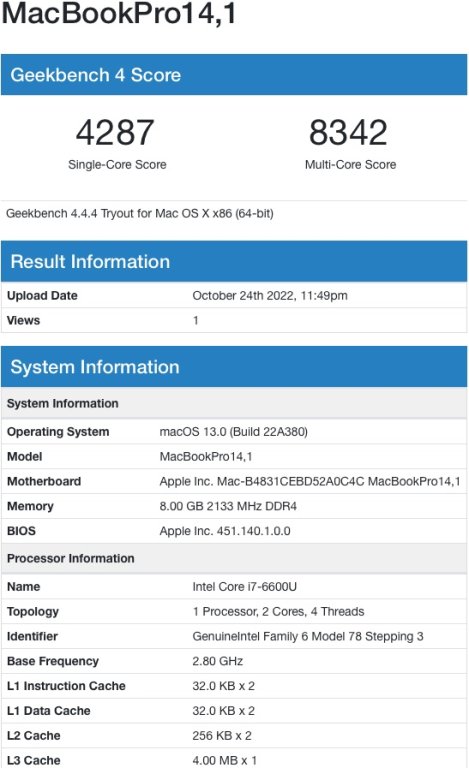

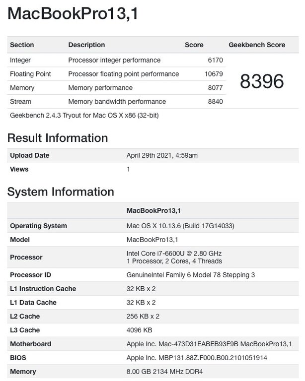

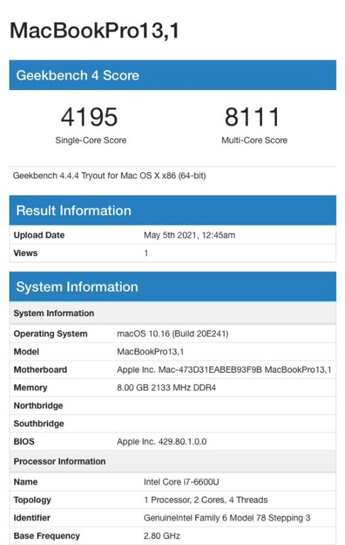

GeekBench v2.4.4 (32bit) gives a near 8400 rating:

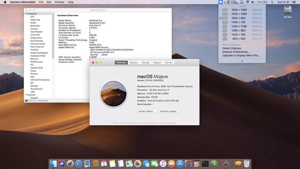

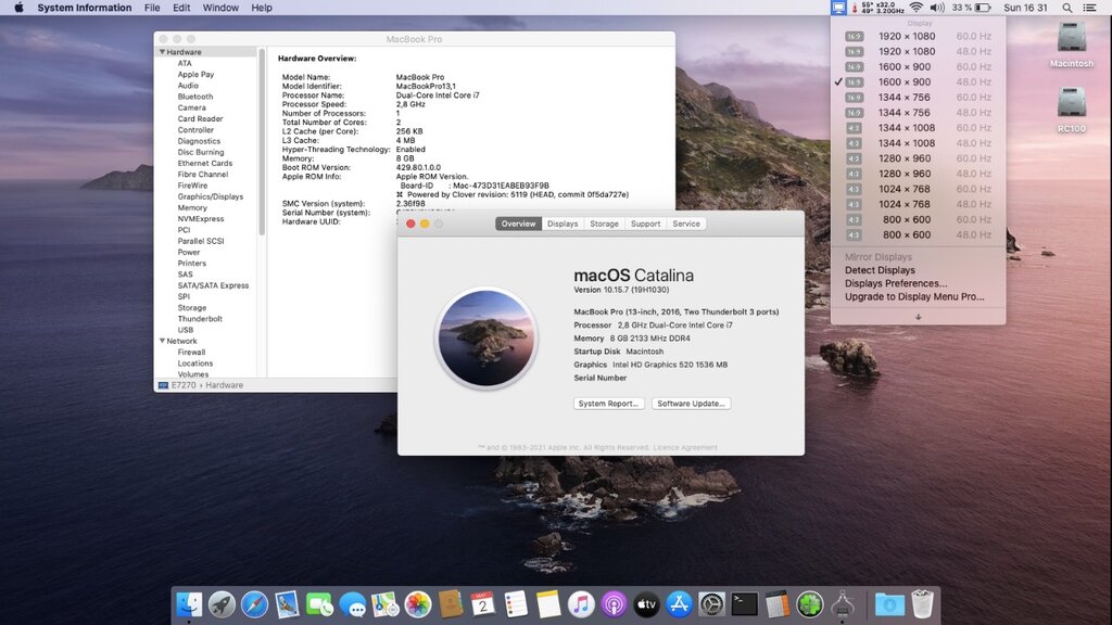

  • Mojave 10.14.x
E7270_i7-6600U_HD520_Moj.jpg     E7270_Moj_SpeedStep#1.jpg     E7270_Moj_SysInfo_SpeedStep#2.jpg
Working:
  • mDP output OOB
  • touchscreen OOB
Not Working:
  • N/A
Not tested:
  • SmartCard reader

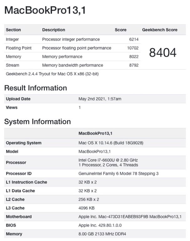

GeekBench v2.4.4 (32bit) gives a good 8400+ rating:

This is a Clover-based installation using the well-known/well documented vanilla method detailed below:
E7270_i7-6600U_HD520_Cat.jpg  E7270_Cat_SpeedStep#1.jpg  E7270_Cat_SpeedStep#2.jpg
Working:
  • mDP output OOB
  • touchscreen OOB
Not Working:
  • N/A
Not tested:
  • SmartCard reader
GeekBench v4.4.4 (64bit) gives the following rating:

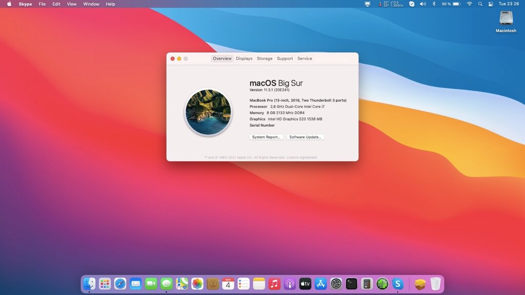

  • Big Sur 11.x
Working:
  • mDP output OOB
  • touchscreen with USB HID fix (patch of IOHIDFamily to fake single-user mode) due to Apple dropping support for old USB hardware
Not Working:
  • N/A
Not tested:
  • SmartCard reader

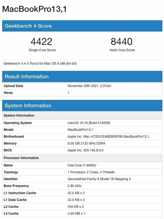

  • Ventura 13.x
Working:
  • full QE/CI with HD520 graphics (with KBL layout 0x59160000, KBL faked id 0x5916, MBP14,1 SMBIOS and Whatevergreen kext v1.6.1 or later)
  • mDP output OOB
  • HDMI audio (with KBL con1 connector-type patch)
  • SD card reader (with 1Revenger1's RealtekCardReader kext)
macOS Ventura not natively supporting platforms older than Kaby Lake/HD6x0, it cannot be natively installed and cannot natively run on the Skylake/HD520 Latitude E7270 as used to be the case for earlier versions of the OS. This can however be easily achieved by implementing the following settings which allow keeping a full vanilla installation without calling on add-on patches that would install older kexts, frameworks or other necessary files:
  1. use of Kaby Lake framebuffer 0x59160000 (0x591B0000 may also be used but requires further graphics connectors patching)
  2. fake Kaby Lake HD620 iGPU id 0x5916
  3. use Kaby Lake platform SMBIOS MacBookPro14,1
  4. use Whatevergreen v1.6.1 minimum to properly support use/fake KBL graphics on Skylake platforms

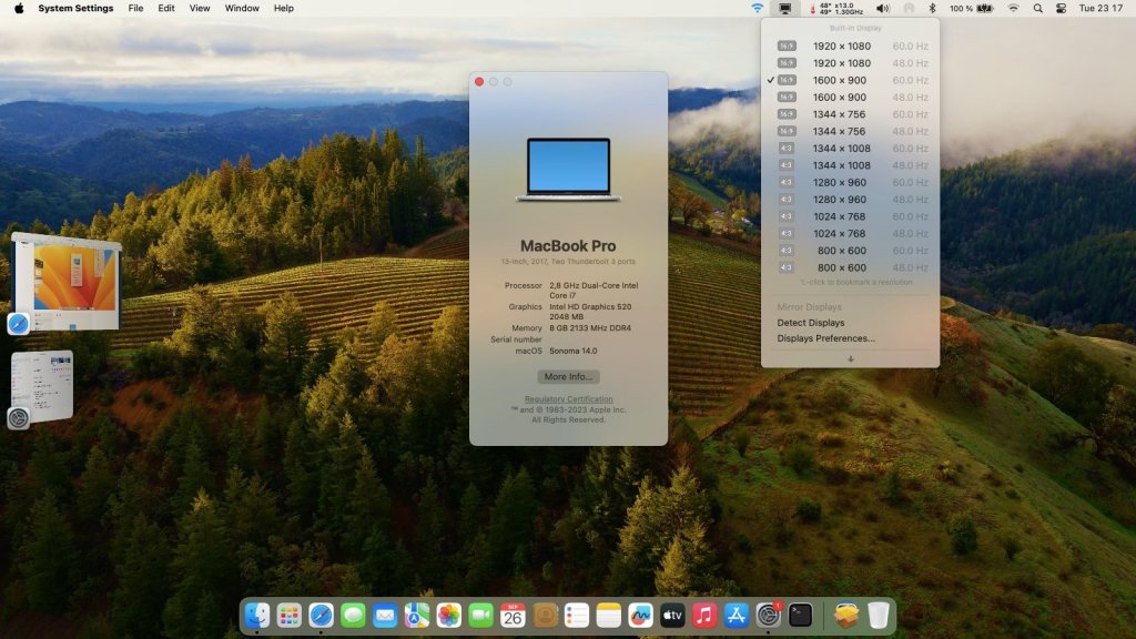

macOS Sonoma not natively supporting platforms older than Amber Lake/Coffee Lake/UHD6x0, it cannot be natively installed and cannot natively run on the Skylake/HD520 Latitude E7270 as used to be the case for earlier versions of the OS up to Monterey. This can however be easily achieved by implementing the following settings which allow keeping a full vanilla installation without calling on add-on patches that would install older kexts, frameworks or other necessary files:
  3. use Coffee Lake platform SMBIOS MacBookPro15,2
  4. use Whatevergreen v1.6.6/v1.6.7 minimum
