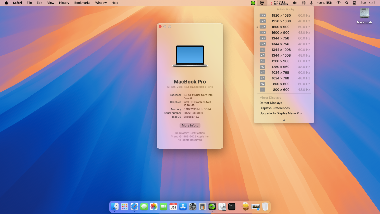

Dell Latitude E7270 with i7-6600U, HD520 and 1920x1080 Touchscreen - High Sierra/Mojave/Catalina/Big Sur/Monterey/Ventura/Sonoma/Sequoia

Target macOS release:
  • Sequoia 15.x
This is a Clover-based installation using the well-known/well documented vanilla method detailed below:
Working:
  • full QE/CI with HD520 graphics (with KBL layout 0x59160000, KBL faked id 0x5916, MBP15,2 SMBIOS and Lilu kext v1.6.8 + Whatevergreen kext v1.6.7 or later)
