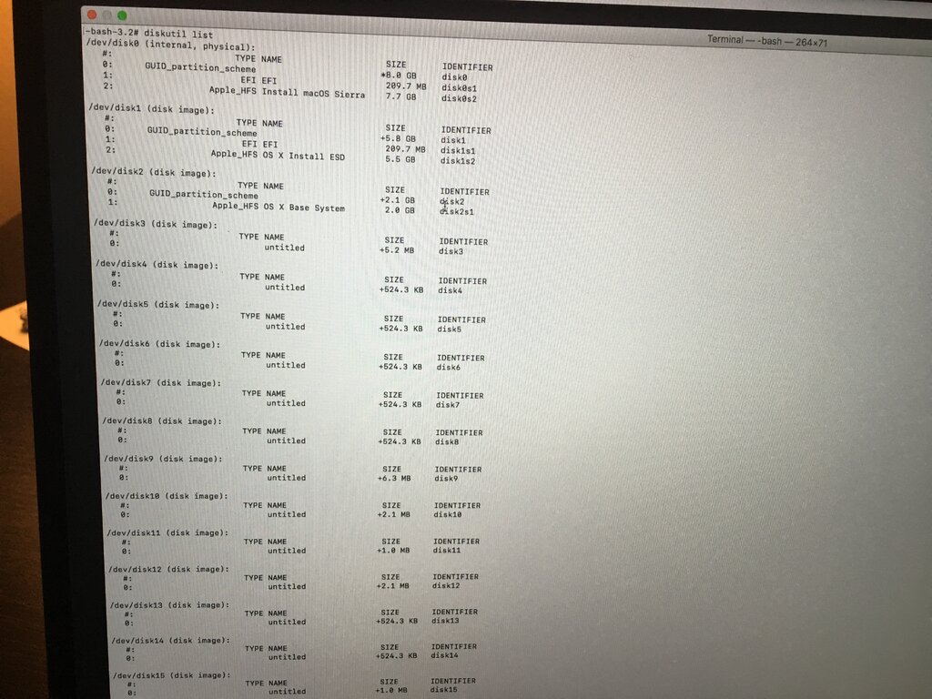

samluu Posted May 4, 2021 Share Posted May 4, 2021 I use this EFI and cant boot into install screen but Catalina does not see the drive. If I change another ssd it show up. The Nvme I used is PC611 NVMe SK hynix 512GB. Does anybody have the same issue? EFI.7z Link to comment Share on other sites More sharing options...
Moderators Jake Lo Posted May 4, 2021 Moderators Share Posted May 4, 2021 you need the NVMe 4k sector patch, don't know if there's one for Opencore See here for supported NVMe drives Link to comment Share on other sites More sharing options...
