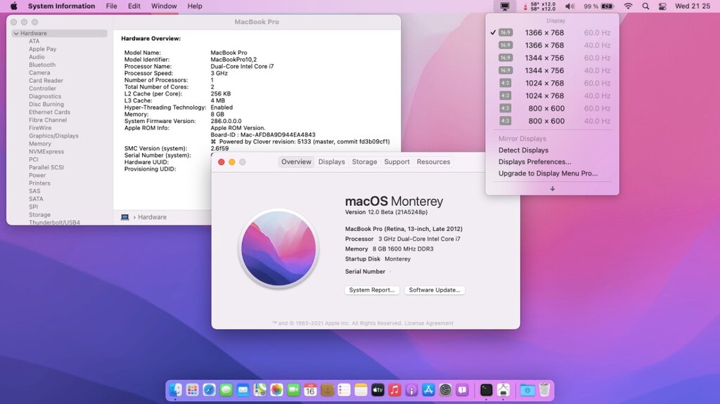

Administrators Hervé Posted June 14, 2021 Author Administrators Share Posted June 14, 2021 OCLP 0.1.7 patcher has been released. It brings support for HD4000 graphics in Monterey beta1. https://forums.macrumors.com/threads/macos-12-monterey-on-unsupported-macs-thread.2299557/post-30014550 Make sure to enable automatic login quickly after 1st boot setup to avoid subsequent problems with the Windows server/graphics initialisation and consequential inability to complete the boot and reach desktop. Tested on my Latitude E6230 on an external USB disk. Runs at much higher CPU speeds than before and therefore very hot at times. Will probably have to experiment with CPUFriend on that front. Probably why system is unstable and keeps crashing with sudden complete reset after a while. Link to comment Share on other sites More sharing options...
