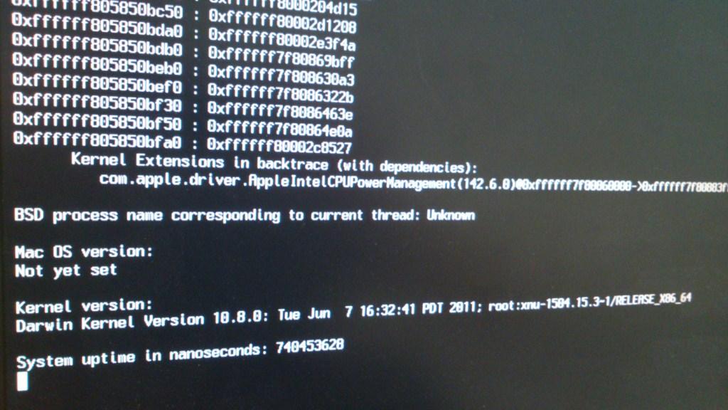

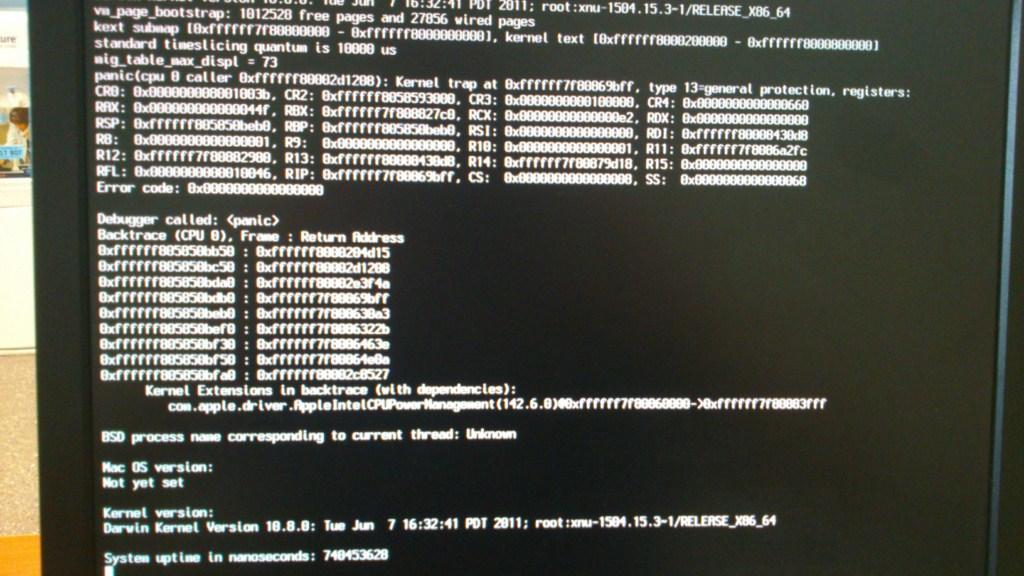

mansi Posted May 27, 2013 Share Posted May 27, 2013 Hello everyone,I have a client with a big problem in his system, but... I have a lot experience with Microsoft Systems, but nothing nothing with MAC OS X :'(I don't know how was installed the system, I have some ideas....The system was working good some days ago...But now... show the error: com.apple.driver.appleintelcpupowermanagement (picture attached)I know the system have Darwin x86 boot... and after this boot, fast show the kernel panic...I don't know how can I repair the system, and please I need your help!!!I'm desperate!!! Thanks in advance!! Link to comment Share on other sites More sharing options...
Administrators Bronxteck Posted May 27, 2013 Administrators Share Posted May 27, 2013 type in at the chameleon boot prompt dart=0 -v if it boots you can add the flag to the org.chameleon.Boot.plist in /Extra folder or you need to replace the kext with version 1.3.5 Link to comment Share on other sites More sharing options...
