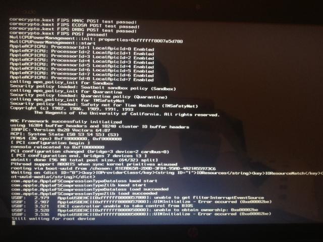

Beta1382643440 Posted August 10, 2012 Share Posted August 10, 2012 I have been working on this for a week and I am still stuck on why I can not get it to work. Ideas? Used: -v -x cpus=1 USBBusFix=Yes System Specs: http://h10025.www1.hp.com/ewfrf/wc/softwareCategory?os=4063&lc=en&cc=us&dlc=en&sw_lang=&product=5119235#N816 Link to comment Share on other sites More sharing options...
Conti Posted August 13, 2012 Share Posted August 13, 2012 Is this a USB installer you are trying to boot? If so I see you are trying the USBBusFix flag and it's not helping the situation - can you crate the installer on an internal SATA device and try to run it from there? (Only need an 8GB partition) Link to comment Share on other sites More sharing options...
Beta1382643440 Posted August 14, 2012 Author Share Posted August 14, 2012 Yes, I am using a external flash drive. I thought I was using the appropriate boot flags and from your response I was. I will follow your recommendation. Link to comment Share on other sites More sharing options...
