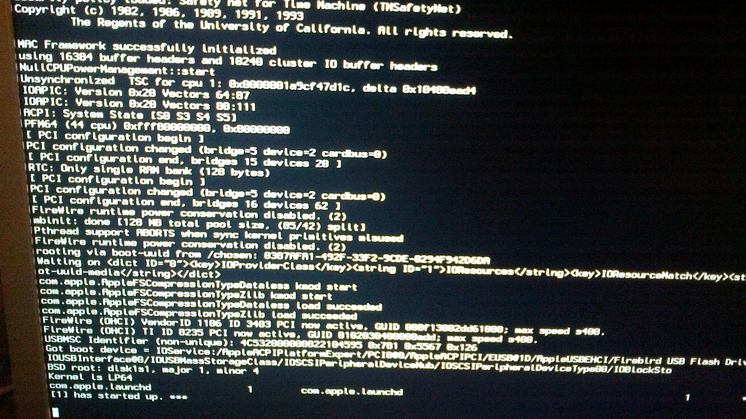

lerenoamp Posted November 13, 2012 Author Share Posted November 13, 2012 I have a 'new' problem, a new GPU arrived, not the one I order either but as it costs more than £100 more than the one I ordered I decided I wouldn't complain about it. An MSI GeForce GTX 660 OC It looks to be supported, but now I can't log into my existing install, and I can't do a fresh Myhack install using the previously working command line of npci=0x2000 cpus=1 Looks to be hanging on the line [PCI Configuration Begin] I think the workaround would be to put back the 9400GT, boot into Mountain Lion, then add the GTX information from within Mountain Lion. Still, that won't fix my other issues, so stuck again. Link to comment Share on other sites More sharing options...
Conti Posted November 15, 2012 Share Posted November 15, 2012 I can't help much with the X79 issues as I have no personal experience with that platform but I did notice something I'd like to point out here... Just to clarify cpus=1 does not limit you to a single core, it limits you to a single cpu socket. The kernel is designed to support multiple processor systems (think mac pro dual cpu xeons) and that causes acpi problems on some systems when the kernel expect to find a second cpu socket but doesn't. All of your cores are still available, you are only telling chameleon to limit OS X to using a single cpu with multiple cores. The hang on PCI Configuration Begin is typically due to unsupported graphics, or improperly initialized graphics in ML. Use zip compression on your dsdt and ioreg and it should be able to be uploaded here. Link to comment Share on other sites More sharing options...
