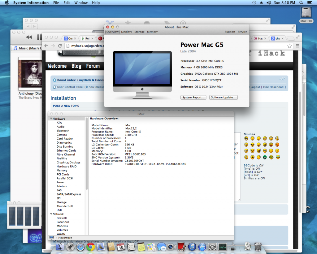

Mac Hosehead Posted June 17, 2013 Share Posted June 17, 2013 I usually don't mess with previews but I am building a new system so I thought I would try it out. I downloaded the lastest myHack and prepared a new USB stick with it. I wanted to see if HD4000 would work but the installer would hang during boot and -v didn't seem to show any panic message. I then tried it with a GTX 280 and it went through the install without a problem until the end. After the Installation Successful screen it came up with an error message before reboot. At reboot it gave an error and did not get to the Chameleon screen. Another site suggested using Chameleon 2.2 svn r2246. I installed it and it booted fine. This does not seem to break myHack and myFix works. This MB has an EFI BIOS and doesn't appear to require a DSDT. I am running with no NullCPUPowerManagement and sleep is working. I haven't seen a panic yet. -MH Link to comment Share on other sites More sharing options...
Mac Hosehead Posted October 27, 2013 Author Share Posted October 27, 2013 I'm running the final now. Chameleon r2266 detects HD4000 without any additional settings. Ivy-Bridge processors on this MB appear to handle power management natively. I tried a Sandy-Bridge processor and got PM KPs. -MH 1 Link to comment Share on other sites More sharing options...
