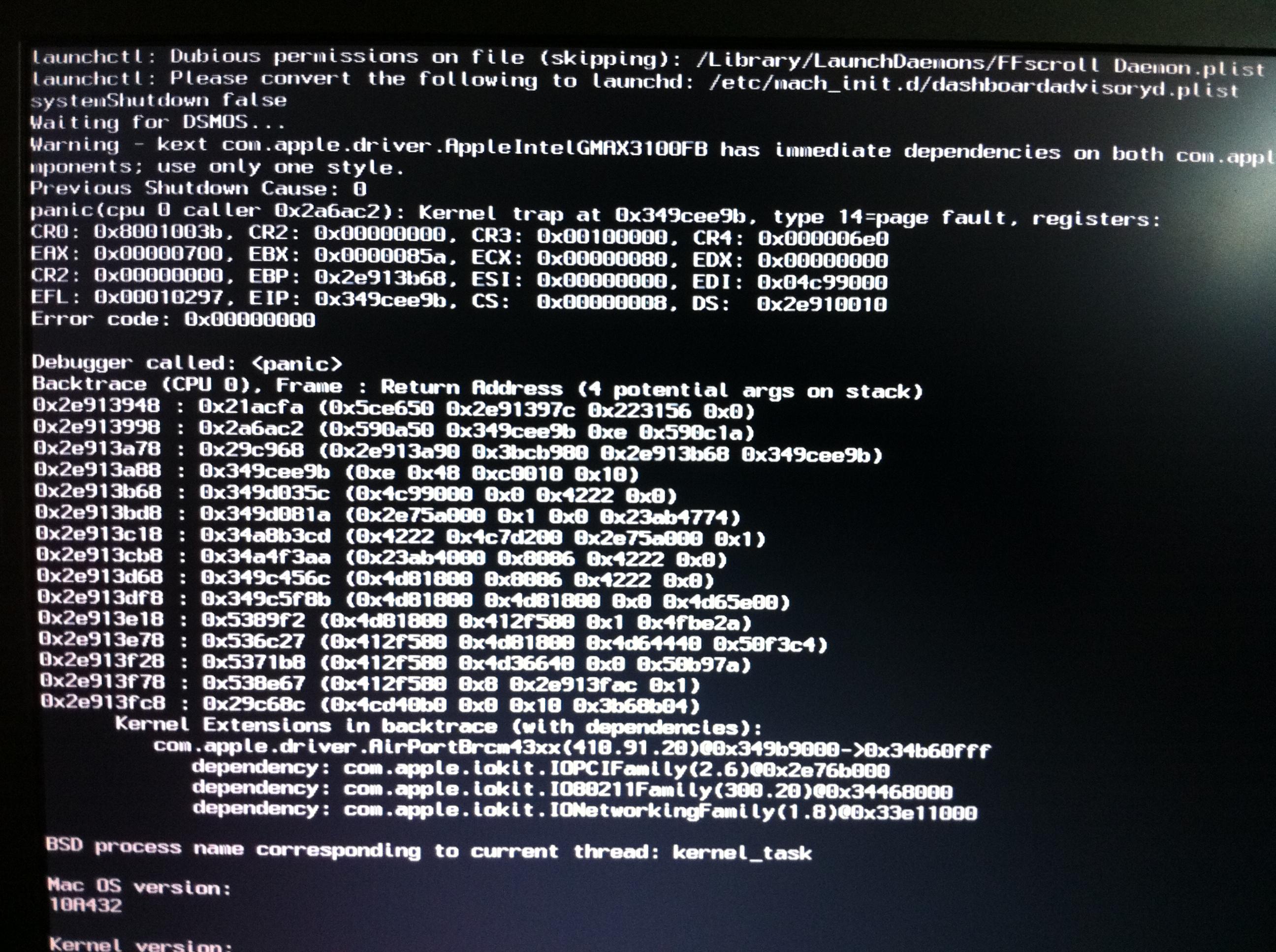

Sudhish K V Posted October 1, 2011 Share Posted October 1, 2011 Hi, I am trying to install Snow Leopard 10.6 on Dell D630. Installed Latest EDP 1.9 for the intel X3100. Any chance the dell d630 comes with other intel graphics. From the screen shot i think the problem is with the graphics. Can you guys help me to fix? Please find the attached for details. Thanks in advance. Sudhish. Link to comment Share on other sites More sharing options...
Administrators Leon Posted October 1, 2011 Administrators Share Posted October 1, 2011 Look at the last couple of lines, your KP is caused by a BCM driver.. most likely for your wireless. try and disable your wireless in bios while installing Link to comment Share on other sites More sharing options...

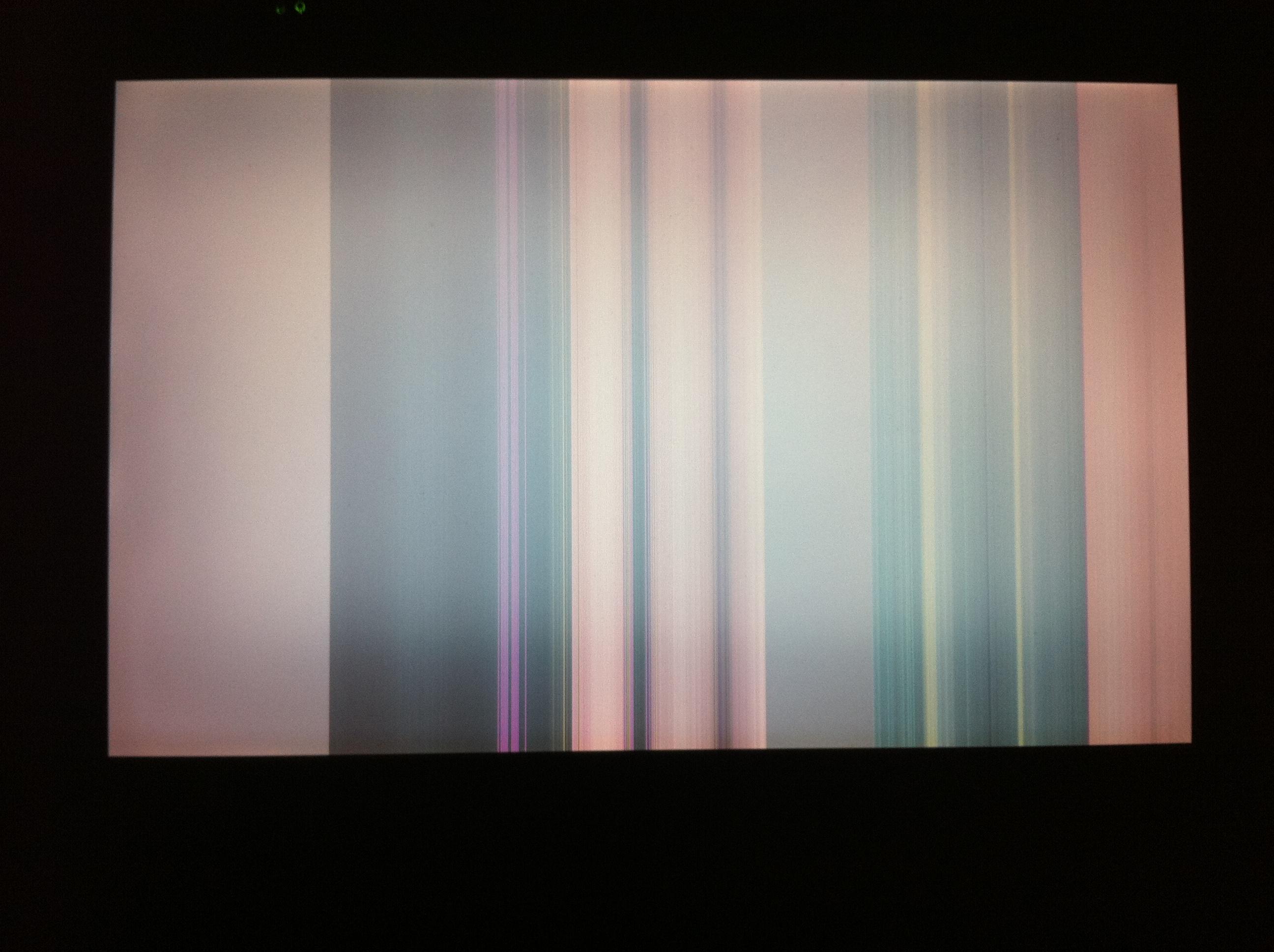

Sudhish K V Posted October 1, 2011 Author Share Posted October 1, 2011 Thank you so much!. I disabled internal Cellular and Internal Wifi, it is not giving kernel panic now. But have issue with the video. Pls check the attached image. I don't know what is my display resoulution. It looks small so i think it could be 1024x768. My guess is setting wrong resolution or refresh rate cosing the issue. Link to comment Share on other sites More sharing options...
Administrators Leon Posted October 2, 2011 Administrators Share Posted October 2, 2011 1. what bios version are you running ? 2. What OSX version ? 3. Have it worked before ? Link to comment Share on other sites More sharing options...
