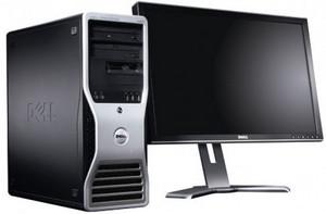

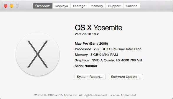

I assisted forum member rjjd to install Yosemite on his Precision 490 workstation.
Target OS X release:
  • Yosemite 10.10.2
Installation fully successful with manually-built 10.10 USB installer + Chameleon v2.2 r2401 bootloader and attached Precision 490 bootpack on a SATA HDD partitioned GUID and formatted Mac OS X (journaled). Initial build in 10.10, followed by 10.10.2 Combo update.
