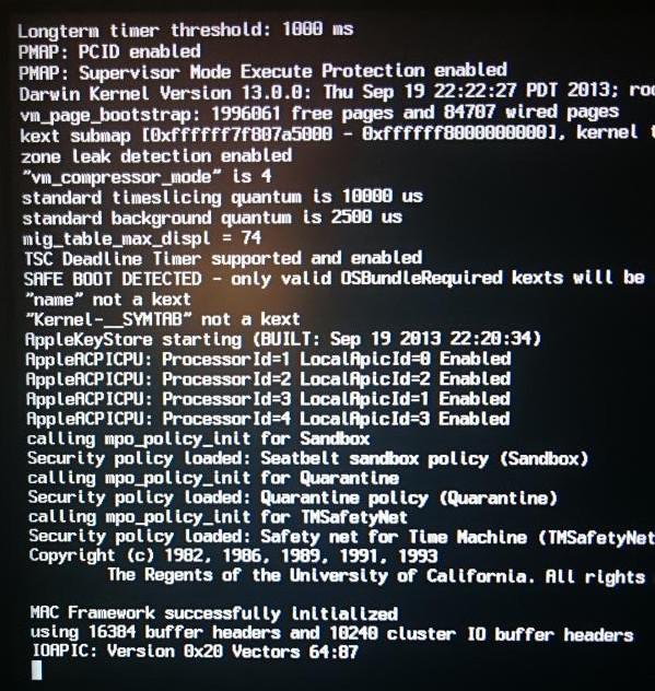

this is the error i get after following this guide https://osxlatitude.com/index.php?/topic/7268-dell-latitude-e6430e6530-with-optimus-enabled/and trying -v, -v -f and -v -f -x
first i got the com.apple.driver.AppleIntelCPUPowerManagement kernel panic so i removed the kext from S/L/E and ran a quick myfix in myhack then booted again using -v and -v -f the install hangs with the following screen:

You are following the wrong guide if you only have the Intel HD4000 and no Nvidia nvs5200M.
See this instead.
If you want Yosemite, look at the the Yosemite guide on the lower right of my signature.
You can't delete AppleIntelCPUPowerManagement, you need that for power management. What you need is patched it, it is included in the bootpack.
