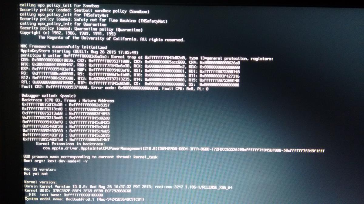

pacokent Posted October 3, 2015 Share Posted October 3, 2015 Hi! I have been trying the whole day installing Mac Os El Capitan as a hackintosh on a Dell Latitude E5420 but it only stays on the Apple Logo and can`t install. I have been trying to put boot flags like -v -f -x GraphicsEnabler=No But I have no succeed . Please Help, What can I do to boot? The error that shows is: System uptime in nanoseconds: Link to comment Share on other sites More sharing options...
Administrators Bronxteck Posted October 3, 2015 Administrators Share Posted October 3, 2015 you need to add nullcpu.kext to your installer you probably will also need patched AICPUPM kext and kernel depending on your boot loader. Link to comment Share on other sites More sharing options...
pacokent Posted October 10, 2015 Author Share Posted October 10, 2015 Hi, Thank you for your comment. How do I add nullcpu.kext and patched AICPUPM kext and kernel? This week I tried with Yosemite-Zone and actually installed but could not make my mouse pad and wifi to work Any Ideas? HELP Link to comment Share on other sites More sharing options...
Administrators Bronxteck Posted October 10, 2015 Administrators Share Posted October 10, 2015 depends on your boot loader for chameleon you have to add nullcpu.kext to Extra/Extensions check to see what your yosemite zone has in the Extra folder if it uses one. if you have intel wifi then you will not have wifi because it is not supported in OS X. it would have to be replaced with a compatible card. for trackpad you can try searching the forum for alps trackpad. Link to comment Share on other sites More sharing options...
