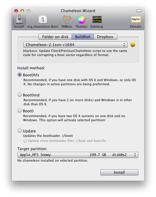

swimmer3000 Posted November 25, 2011 Author Share Posted November 25, 2011 Yes, I did. When i check the org.chameleon.boot.plist file after I saved in the chameleon wizard, I see them listed in the file. In the mean time I also replace the org.chameleon.boot.plist file with the one that I found in the folder /extra/models/D620-intel, but that did not change the booting behavior. In chameleon wizard there is the option ' Buildbot' which i am afraid to use. Anyway, on the bottom there is a dropbox where underneath there is the message that there is no chameleon installed on the selected partition. The partition listed is the only one I can pick. I have added a screenshot of it. Is it possible that there is a separate EFI partition that I cannot see? Sorry, if I ask a question with an obvious answer - that is; that I could have found on the website - here. Finally, I also add below the output of the bdmesg of chameleon wizard, which I think is an overview of the booting process. I want to add, that for the rest the install is working perfectly!! I want to thank all the people that made this possible for a newbe such as me. Cheers, Swimmer --- begin bdmesg --- Chameleon 2.1svn (svn-r1684) [2011-11-01 02:59:36] msr(365): ia32_perf_stat 0x06000b2c max: 11 current: 11 CPU: Brand String: Genuine Intel® CPU T2400 @ 1.83GHz CPU: Vendor/Family/ExtFamily: 0x756e6547/0x6/0x0 CPU: Model/ExtModel/Stepping: 0xe/0x0/0x8 CPU: MaxCoef/CurrCoef: 0xb/0xb CPU: MaxDiv/CurrDiv: 0x0/0x0 CPU: TSCFreq: 1830MHz CPU: FSBFreq: 166MHz CPU: CPUFreq: 1830MHz CPU: NoCores/NoThreads: 2/2 CPU: Features: 0x0000030f Attempting to read GPT Read GPT Reading GPT partition 1, type C12A7328-F81F-11D2-BA4B-00A0C93EC93B Reading GPT partition 2, type 48465300-0000-11AA-AA11-00306543ECAC Invalid mach magic 0x2 Module 'Symbols.dylib' by 'Chameleon' Loaded. Description: Chameleon symbols for linking Version: 0 Compat: 0 Darwin/x86 boot v5.0.132 - Chameleon v2.1svn r1684 Build date: 2011-11-01 02:59:36 2038MB memory VESA v3.0 7MB (Intel® 82945GM Chipset Family Graphics Chip Accelerated VGA BIOS) Scanning device 80...Use keys to select the startup volume. hd(0,2) Snowy Press Enter to start up Darwin/x86 with no options, or you can: Type -v and press Enter to start up with diagnostic messages Type ? and press Enter to learn about advanced startup options boot: Read HFS+ file: [hd(0,2)/Library/Preferences/SystemConfiguration/com.apple.Boot.plist] 290 bytes. Read HFS+ file: [hd(0,2)/Extra/org.chameleon.Boot.plist] 744 bytes. Read HFS+ file: [hd(0,2)/System/Library/CoreServices/SystemVersion.plist] 479 bytes. Loading Darwin 10.6 Loading kernel /mach_kernel Read HFS+ file: [hd(0,2)/mach_kernel] 4096 bytes. Read HFS+ file: [hd(0,2)/mach_kernel] 7454537 bytes. Using PCI-Root-UID value: 0 Intel Mobile GMA950 [8086:27a2] :: PciRoot(0x0)/Pci(0x2,0x0) LAN Controller [14e4:1600] :: PciRoot(0x0)/Pci(0x1c,0x2)/Pci(0x0,0x0) Setting up lan keys Read HFS+ file: [hd(0,2)/Extra/smbios.plist] 843 bytes. SMBus CmdReg: 0x101 Scanning SMBus [8086:27da], mmio: 0x0, ioport: 0x10c0, hostc: 0x3 SPD[0] (size): 128 @0x50 Slot: 0 Type 19 1024MB (DDR2 SDRAM) 667MHz Vendor=Kingston PartNo=9905295-015.B00LF SerialNo=B0142181 SPD[0] (size): 255 @0x51 SPD[0] (size): 128 @0x52 Slot: 2 Type 19 1024MB (DDR2 SDRAM) 667MHz Vendor=Kingston PartNo=9905295-015.B00LF SerialNo=B1141E81 SPD[0] (size): 255 @0x53 SPD[0] (size): 255 @0x54 SPD[0] (size): 255 @0x55 SPD[0] (size): 255 @0x56 SPD[0] (size): 255 @0x57 CPU is Genuine Intel® CPU T2400 @ 1.83GHz, family 0x6, model 0xe Type: 218, Length: 251, Handle: 0xda00 Type: 218, Length: 251, Handle: 0xda01 Type: 218, Length: 251, Handle: 0xda02 Type: 218, Length: 47, Handle: 0xda03 Type: 0, Length: 24, Handle: 0x0 BIOSInformation: vendor: Apple Inc. version: MB21.00A5.B07 releaseDate: 2/29/2008 Type: 1, Length: 27, Handle: 0x100 SystemInformation: manufacturer: Apple Inc. productName: MacBook2,1 version: 1.1 serialNumber: 5W4ZPC123 uuid: 44454C4C-5300-1030-8034-B9C04F43324A wakeupReason: 0x6 skuNumber: bà family: MacBook Type: 2, Length: 9, Handle: 0x200 BaseBoard: manufacturer: Apple Computer, Inc. product: Mac-F42C88C8 version: bà serialNumber: .9S04C2J.CN12961665C248. assetTagNumber: bà locationInChassis: boardType: 0x65 Type: 3, Length: 13, Handle: 0x300 SystemEnclosure: manufacturer: Dell Inc. type: 8 version: bà serialNumber: 9S04C2J assetTagNumber: bà Type: 126, Length: 13, Handle: 0x301 Type: 4, Length: 40, Handle: 0x400 ProcessorInformation: socketDesignation: Microprocessor processorType: 3 processorFamily: 0xB9 manufacturer: Intel processorID: 0x6E8 processorVersion: bà externalClock: 166MHz maximumClock: 1830MHz currentClock: 1833MHz serialNumber: bà assetTag: bà partNumber: bà Type: 7, Length: 19, Handle: 0x700 Type: 7, Length: 19, Handle: 0x701 Type: 126, Length: 9, Handle: 0x800 Type: 8, Length: 9, Handle: 0x801 Type: 126, Length: 9, Handle: 0x803 Type: 8, Length: 9, Handle: 0x804 Type: 126, Length: 9, Handle: 0x805 Type: 8, Length: 9, Handle: 0x806 Type: 126, Length: 9, Handle: 0x808 Type: 8, Length: 9, Handle: 0x809 Type: 126, Length: 9, Handle: 0x80a Type: 8, Length: 9, Handle: 0x80c Type: 8, Length: 9, Handle: 0x80d Type: 9, Length: 13, Handle: 0x900 Type: 126, Length: 13, Handle: 0x902 Type: 10, Length: 6, Handle: 0xa00 Type: 10, Length: 6, Handle: 0xa01 Type: 11, Length: 5, Handle: 0xb00 Type: 13, Length: 22, Handle: 0xd00 Type: 16, Length: 15, Handle: 0x1000 Type: 17, Length: 27, Handle: 0x1100 MemoryDevice: deviceLocator: DIMM_A bankLocator: bà memoryType: DDR2 SDRAM memorySpeed: 667MHz manufacturer: Apple Computer Inc. serialNumber: B0142181 assetTag: 000720 partNumber: 9905295-015.B00LF Type: 17, Length: 27, Handle: 0x1101 MemoryDevice: deviceLocator: DIMM_B bankLocator: bà memoryType: DDR2 SDRAM memorySpeed: 667MHz manufacturer: Apple Computer Inc. serialNumber: B1141E81 assetTag: 000720 partNumber: 9905295-015.B00LF Type: 19, Length: 15, Handle: 0x1300 Type: 19, Length: 15, Handle: 0x1301 Type: 20, Length: 19, Handle: 0x1400 Type: 20, Length: 19, Handle: 0x1401 Type: 20, Length: 19, Handle: 0x1402 Type: 21, Length: 7, Handle: 0x1500 Type: 22, Length: 26, Handle: 0x1600 Type: 126, Length: 26, Handle: 0x1601 Type: 126, Length: 26, Handle: 0x1602 Type: 27, Length: 12, Handle: 0x1b00 Type: 28, Length: 20, Handle: 0x1c00 Type: 32, Length: 11, Handle: 0x2000 Type: 176, Length: 5, Handle: 0xb000 Type: 177, Length: 12, Handle: 0xb100 Type: 178, Length: 6, Handle: 0xb200 Type: 208, Length: 10, Handle: 0xd000 Type: 126, Length: 12, Handle: 0xd100 Type: 210, Length: 12, Handle: 0xd200 Type: 211, Length: 13, Handle: 0xd300 Type: 216, Length: 9, Handle: 0xd800 Type: 217, Length: 8, Handle: 0xd900 Type: 219, Length: 9, Handle: 0xdb00 Type: 126, Length: 9, Handle: 0xdb80 Type: 126, Length: 9, Handle: 0xdb81 Type: 129, Length: 8, Handle: 0x8100 Type: 220, Length: 22, Handle: 0xdc00 Type: 221, Length: 19, Handle: 0xdd00 Type: 212, Length: 47, Handle: 0xd400 Type: 222, Length: 13, Handle: 0xde00 Type: 131, Length: 6, Handle: 0xde00 AppleProcessorType: ProcessorType: 0x301 Type: 127, Length: 4, Handle: 0xde01 Customizing SystemID with : 44454c4c-5300-1030-8034-b9c04f43324a Read HFS+ file: [hd(0,2)/Extra/DSDT.aml] 19979 bytes. ACPI table not found: SSDT.aml FADT: Restart Fix applied! FADT: Using custom DSDT! Found ACPI CPU: CPU0 Found ACPI CPU: CPU1 SSDT with CPU C-States generated successfully SSDT with CPU P-States generated successfully RSDT: Added 2 SSDT table(s) LoadDrivers: Loading from [/Extra/Extensions.mkext] Read HFS+ file: [hd(0,2)/Extra/Extensions.mkext] 4096 bytes. Read HFS+ file: [hd(0,2)/Extra/Extensions.mkext] 1036528 bytes. LoadDrivers: Loading from [/system/Library/Caches/com.apple.kext.caches/Startup/Extensions.mkext] Read HFS+ file: [hd(0,2)/System/Library/Caches/com.apple.kext.caches/Startup/Extensions.mkext] 4096 bytes. Read HFS+ file: [hd(0,2)/System/Library/Caches/com.apple.kext.caches/Startup/Extensions.mkext] 5354643 bytes. Starting Darwin x86 Read HFS+ file: [hd(0,2)/Extra/Themes/Default/boot.png] 8801 bytes. --- end bdmesg--- Link to comment Share on other sites More sharing options...
Administrators Bronxteck Posted November 25, 2011 Administrators Share Posted November 25, 2011 yeah you might have settings in a different partition... it shows 2 Attempting to read GPT Read GPT Reading GPT partition 1, type C12A7328-F81F-11D2-BA4B-00A0C93EC93B Reading GPT partition 2, type 48465300-0000-11AA-AA11-00306543ECAC looks to be reading from this drive/partition Read HFS+ file: [hd(0,2)/Extra/ Link to comment Share on other sites More sharing options...
swimmer3000 Posted November 25, 2011 Author Share Posted November 25, 2011 Dear Bronxteck Thank your for your reply. Is there any hint how I could 'mount' this partition, because the only thing I can see is the sole partition that is listed in Chameleon wizard in the picture. In the past I came across a posting on a website that mentioned that is was possible to load an EFI partition? Perhaps if I could do that I could change the settings. I am reluctant to install Chameleon on the hd(0,2) (as chameleon wizard is saying it is not installed there) because I have read that you should not install two versions on separate partitions. All help is welcome here. THanks, Swimmer. Link to comment Share on other sites More sharing options...
Administrators Bronxteck Posted November 26, 2011 Administrators Share Posted November 26, 2011 well chameleon wizard has efi support but you have to enable it in it's preferences on the top right . then you can mount it if you have one. but it is calling from hd(0,2)/Extra/ it might be set as your default drive. make the change there if you care to test, copy then rename the extra folder in that partition/drive make the changes if it doesn't work then rename your original extra folder back to Extra. Link to comment Share on other sites More sharing options...

swimmer3000 Posted November 27, 2011 Author Share Posted November 27, 2011 Dear Bronxteck, Thanks for the hint, but I tried many things and they do not work out. You might be on to something, because with trial and error I think I discovered that the org.Chameleon.boot.plist file is loaded AFTER I have to press <ENTER> to continue booting. In addition, Chameleon Wizard says that Chameleon-2.1.svn-r1684 is not installed on my hd(0,2) partition. But my computer still boots with a bootloader that says it is Chameleon-2.1.svn-r1684 that is loaded. I am really at a loss here. I agree with you that apparently there is a Chameleon-2.1.svn-r1684 'version' that is booting from 'somewhere', but I do not know from where. Next, after I press <ENTER> only then the org.Chameleon.boot.plist in hd(0,2)/Extra is loaded, but then it is of 'no use' anymore, because there is 'already' a version of Chameleon loaded where the options do not matter that much. I am at a loss here. Thanks for any help that anyone can give me. Cheers, Swimmer. Link to comment Share on other sites More sharing options...
swimmer3000 Posted November 27, 2011 Author Share Posted November 27, 2011 Dear all, I have solved the problem! After some trial and error I messed up really the bootloader. Ending up doing a complete reinstall of the system. Then in EDP, when it came to install Chameleon, I took a good look at the installation options. There is a button called 'customize' and when you press that you get all kind of information. Including the default installation 'place', which is EFI. I changed that to 'standard' and then, after some thinking with some details here and there, everything works. Perhaps it is an option to change the standard installation path to 'standard' instead of EFI in EDP? It is just a suggestion. In the end I am loving my new system. If only I had a Core 2 Duo processor, because then I could install Lion as well The one thing I would love to change is the 'standard 'boot.png' logo of my theme (which is a black apple logo, to the 'osxlatitude apple logo'. In my previous install I had the latter as the logo, but I cannot seem to find it anymore. Can anyone tell me where I can download it? Cheers, Swimmer. Link to comment Share on other sites More sharing options...
