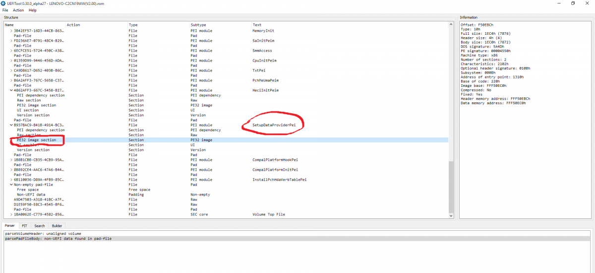

Moderators Jake Lo Posted June 2, 2016 Moderators Share Posted June 2, 2016 Remove the check next to Custom and it should default to 16384k. Select Read, then Backup Link to comment Share on other sites More sharing options...

Moderators Jake Lo Posted June 7, 2016 Moderators Share Posted June 7, 2016 @nasa11 Search for SetupUtility and then export the pe32 Image section. You should find DVMT at 0x18c. If that still doesn't work, try 0x18d as well. Link to comment Share on other sites More sharing options...
