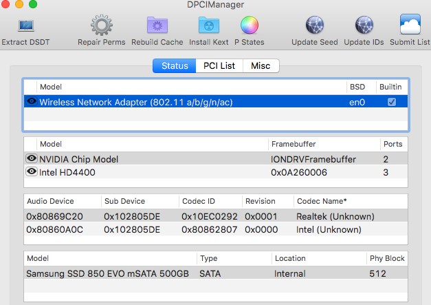

tonio92 Posted October 1, 2016 Author Share Posted October 1, 2016 After Reboot and Post installation with the four kexts in L/E and S/L/E it seems that Screen of the laptop (Apple desappeard during boot) is not activated but HDMI is OK When i check audio configuration , audio installation seems to be OK The problem is a bad configuration or a conflict between HDMI and CRT after post installation or during rebuild permissions Link to comment Share on other sites More sharing options...
Moderators Jake Lo Posted October 1, 2016 Moderators Share Posted October 1, 2016 Seems I have missed the fact that your system has a second display (Nvidia). You'll need to get that disable either in the BIOS or through DSDT. As far as I know, Dell Latitude don't have that option in the BIOS, so you'll have to do it through DSDT. Link to comment Share on other sites More sharing options...
