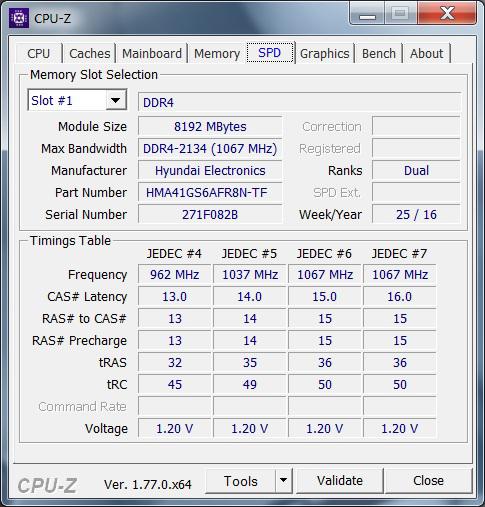

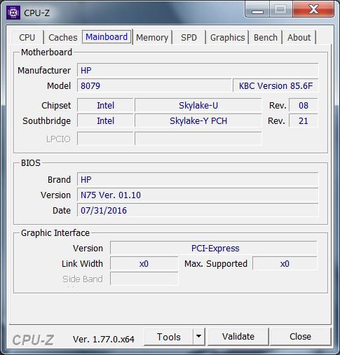

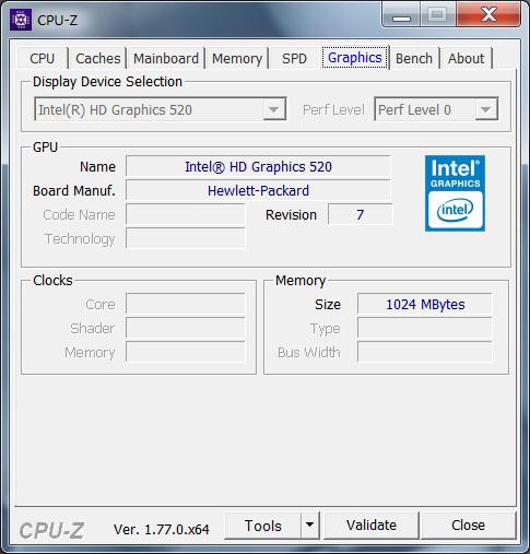

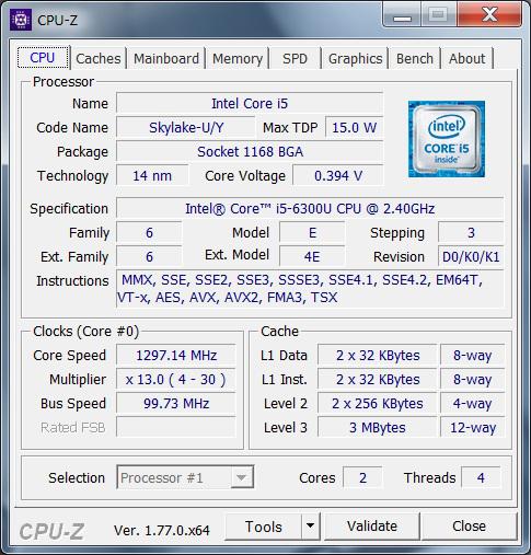

Bornnslippy Posted November 21, 2016 Share Posted November 21, 2016 Hi I'm just wondering if possible to install osx on this laptop? If so could someone point me in the right direction Thanks Link to comment Share on other sites More sharing options...
Moderators Jake Lo Posted November 21, 2016 Moderators Share Posted November 21, 2016 Follow my E7470 guide and bootpack, leave off the DSDT/SSDT in ACPI/Patched folder. You'll have to follow the Prerequisite to set the DVMT to 96mb, don't use the value(s) in the guide, as yours might be different. Extract the raw files with F4 during Clover boot, and attach the compress /EFI/Clover/ACPI/Origin folder here for patching. Link to comment Share on other sites More sharing options...
