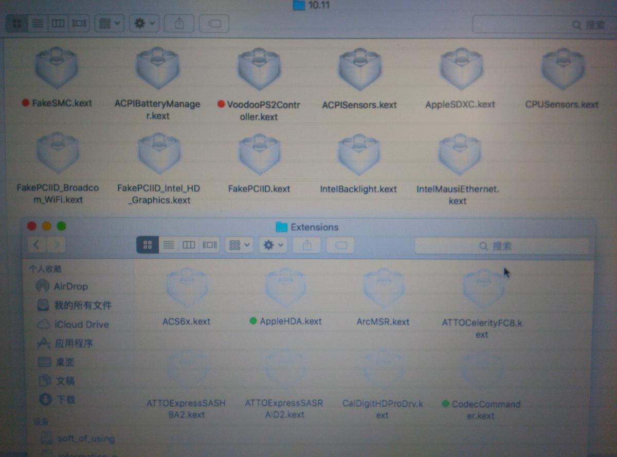

sowhat4999 Posted November 30, 2016 Share Posted November 30, 2016 Hello guys, I installed EI Caption on my laptop, everything was right but sleeping issuess. after slept and pressed button to wake up, The screen showed the desktop and then reboot.(About 2s) The configure of laptop were different from others on cpu and resolution(mine were intel core i5 and 1366*768). Kext files of Clover kext folder was upload, please check the attached files. After restart, The computer showed the error infromation like following: Anonymous UUID: 8530CE08-161B-E9BC-4388-E3A7173076C0 Wed Nov 30 15:42:11 2016 *** Panic Report *** panic(cpu 0 caller 0xffffff80065cf1ba): "Double fault at 0xffffff80065ad06f, registers:\n" "CR0: 0x000000008001003b, CR2: 0xffffff810c8839a8, CR3: 0x000000000e97b000, CR4: 0x00000000001627e0\n" "RAX: 0x00000000001627e0, RBX: 0xffffff8006cee6d0, RCX: 0x0000000000162760, RDX: 0xffffff8006c2cef0\n" "RSP: 0xffffff810c8839b0, RBP: 0xffffff810c883a40, RSI: 0x000000000e97b000, RDI: 0x0000000000000001\n" "R8: 0x0000000000000000, R9: 0x0000000000000000, R10: 0xbfffffffffffff01, R11: 0x0000000000000001\n" "R12: 0x0000000000000001, R13: 0x0000000000000010, R14: 0x0000000000000001, R15: 0x0000000000000004\n" "RFL: 0x0000000000010202, RIP: 0xffffff80065ad06f, CS: 0x0000000000000008, SS: 0x0000000000000010\n" "Error code: 0x0000000000000000\n"@/Library/Caches/com.apple.xbs/Sources/xnu/xnu-3248.60.10/osfmk/i386/trap_native.c:168 Backtrace (CPU 0), Frame : Return Address 0xffffff80ec4eecf0 : 0xffffff80064dab52 0xffffff80ec4eed70 : 0xffffff80065cf1ba 0xffffff80ec4eeed0 : 0xffffff80065ece1f No mapping exists for frame pointer Backtrace terminated-invalid frame pointer 0xffffff810c883a40 BSD process name corresponding to current thread: kernel_task Boot args: dart=0 cpus=1 kext-dev-mode=1 Mac OS version: 15G31 Kernel version: Darwin Kernel Version 15.6.0: Thu Jun 23 18:25:34 PDT 2016; root:xnu-3248.60.10~1/RELEASE_X86_64 Kernel UUID: B5AA8E3E-65B6-3D0E-867B-8DCCF81E536C Kernel slide: 0x0000000006200000 Kernel text base: 0xffffff8006400000 __HIB text base: 0xffffff8006300000 System model name: MacBookAir6,2 (Mac-7DF21CB3ED6977E5) System uptime in nanoseconds: 436306483441 last loaded kext at 177809594401: com.apple.filesystems.msdosfs 1.10 (addr 0xffffff7f8750e000, size 69632) loaded kexts: com.tuxera.filesystems.tufsfs.fusefs_txantfs 2015.11.5 org.tw.CodecCommander 2.2.1 pk.qwerty12.DisableTurboBoostBattery 2 org.emlydinesh.driver.EAPDFix 2.1 org.rehabman.voodoo.driver.PS2Mouse 1.8.9 org.rehabman.voodoo.driver.PS2Trackpad 1.8.9 org.rehabman.voodoo.driver.PS2Keyboard 1.8.9 com.insanelymac.IntelMausiEthernet 2.0.0d2 org.rehabman.driver.FakePCIID 1.3.2 org.hwsensors.driver.ACPISensors 1406 com.darwin.driver.IntelBacklight 1.0.0d1 org.rehabman.voodoo.driver.PS2Controller 1.8.9 org.hwsensors.driver.CPUSensors 1406 org.netkas.driver.FakeSMC 1406 org.rehabman.driver.AppleSmartBatteryManager 1.60.4 com.apple.filesystems.msdosfs 1.10 com.apple.driver.AudioAUUC 1.70 com.apple.driver.X86PlatformShim 1.0.0 com.apple.driver.AGPM 110.22.0 com.apple.driver.ApplePlatformEnabler 2.6.0d0 com.apple.filesystems.autofs 3.0 com.apple.driver.AppleGraphicsDevicePolicy 3.12.7 com.apple.driver.AppleUpstreamUserClient 3.6.1 com.apple.driver.AppleMCCSControl 1.2.13 com.apple.driver.AppleHDAHardwareConfigDriver 274.12 com.apple.driver.AppleHDA 274.12 com.apple.driver.AppleOSXWatchdog 1 com.apple.driver.ACPI_SMC_PlatformPlugin 1.0.0 com.apple.driver.AppleLPC 3.1 com.apple.driver.pmtelemetry 1 com.apple.iokit.IOUserEthernet 1.0.1 com.apple.iokit.IOBluetoothSerialManager 4.4.6f1 com.apple.Dont_Steal_Mac_OS_X 7.0.0 com.apple.driver.AppleHV 1 com.apple.driver.AppleIntelSlowAdaptiveClocking 4.0.0 com.apple.driver.AppleFIVRDriver 4.1.0 com.apple.driver.AppleIntelHD5000Graphics 10.1.4 com.apple.driver.AppleIntelFramebufferAzul 10.1.4 com.apple.iokit.IOAHCIBlockStorage 2.8.5 com.apple.driver.AppleFileSystemDriver 3.0.1 com.apple.AppleFSCompression.AppleFSCompressionTypeDataless 1.0.0d1 com.apple.AppleFSCompression.AppleFSCompressionTypeZlib 1.0.0 com.apple.BootCache 38 com.apple.driver.AppleAHCIPort 3.1.8 com.apple.driver.usb.AppleUSBEHCIPCI 1.0.1 com.apple.driver.AppleSDXC 1.7.0 com.apple.driver.AirPort.Atheros40 700.74.5 com.apple.driver.AppleACPIButtons 4.0 com.apple.driver.AppleACPIEC 4.0 com.apple.driver.AppleRTC 2.0 com.apple.driver.AppleHPET 1.8 com.apple.driver.AppleSMBIOS 2.1 com.apple.driver.AppleAPIC 1.7 com.apple.nke.applicationfirewall 163 com.apple.security.quarantine 3 com.apple.security.TMSafetyNet 8 com.apple.kext.triggers 1.0 com.apple.driver.AppleGraphicsControl 3.12.8 com.apple.driver.DspFuncLib 274.12 com.apple.kext.OSvKernDSPLib 525 com.apple.driver.AppleSMBusController 1.0.14d1 com.apple.driver.IOPlatformPluginLegacy 1.0.0 com.apple.driver.X86PlatformPlugin 1.0.0 com.apple.driver.AppleSMBusPCI 1.0.14d1 com.apple.driver.IOPlatformPluginFamily 6.0.0d7 com.apple.driver.AppleHDAController 274.12 com.apple.iokit.IOHDAFamily 274.12 com.apple.driver.AppleIntelLpssUARTv0 2.0.60 com.apple.driver.AppleIntelLpssUARTCommon 2.0.60 com.apple.driver.AppleIntelLpssDmac 2.0.60 com.apple.iokit.IOAudioFamily 204.4 com.apple.vecLib.kext 1.2.0 com.apple.iokit.IOSerialFamily 11 com.apple.iokit.IOBluetoothFamily 4.4.6f1 com.apple.driver.AppleSMC 3.1.9 com.apple.driver.CoreCaptureResponder 1 com.apple.iokit.IOSlowAdaptiveClockingFamily 1.0.0 com.apple.iokit.IOSurface 108.2.3 com.apple.iokit.IONDRVSupport 2.4.1 com.apple.AppleGraphicsDeviceControl 3.12.8 com.apple.iokit.IOAcceleratorFamily2 205.11 com.apple.iokit.IOSCSIArchitectureModelFamily 3.7.7 com.apple.driver.AppleXsanScheme 3 com.apple.driver.usb.cdc 5.0.0 com.apple.driver.usb.networking 5.0.0 com.apple.driver.usb.AppleUSBHostCompositeDevice 1.0.1 com.apple.driver.usb.AppleUSBHub 1.0.1 com.apple.driver.AppleEFINVRAM 2.0 com.apple.iokit.IOUSBFamily 900.4.1 com.apple.iokit.IOAHCIFamily 2.8.1 com.apple.driver.usb.AppleUSBEHCI 1.0.1 com.apple.iokit.IO80211Family 1110.26 com.apple.driver.corecapture 1.0.4 com.apple.driver.AppleIntelLpssGspi 2.0.60 com.apple.iokit.IONetworkingFamily 3.2 com.apple.driver.usb.AppleUSBXHCIPCI 1.0.1 com.apple.driver.usb.AppleUSBXHCI 1.0.1 com.apple.iokit.IOUSBHostFamily 1.0.1 com.apple.driver.AppleUSBHostMergeProperties 1.0.1 com.apple.driver.AppleEFIRuntime 2.0 com.apple.iokit.IOGraphicsFamily 2.4.1 com.apple.iokit.IOHIDFamily 2.0.0 com.apple.iokit.IOSMBusFamily 1.1 com.apple.security.sandbox 300.0 com.apple.kext.AppleMatch 1.0.0d1 com.apple.driver.AppleKeyStore 2 com.apple.driver.AppleMobileFileIntegrity 1.0.5 com.apple.driver.AppleCredentialManager 1.0 com.apple.driver.DiskImages 417.4 com.apple.iokit.IOStorageFamily 2.1 com.apple.iokit.IOReportFamily 31 com.apple.driver.AppleFDEKeyStore 28.30 com.apple.driver.AppleACPIPlatform 4.0 com.apple.iokit.IOPCIFamily 2.9 com.apple.iokit.IOACPIFamily 1.4 com.apple.kec.pthread 1 com.apple.kec.Libm 1 com.apple.kec.corecrypto 1.0 Model: MacBookAir6,2, BootROM MBA61.0099.B04, 2 processors, Intel Core i5, 2.59 GHz, 8 GB, SMC 2.13f9 Graphics: Intel HD Graphics 4400, Intel HD Graphics 4400, Built-In Memory Module: BANK0/DIMM0, 4 GB, DDR3, 1600 MHz, Samsung, M471B5173EB0-YK0E1 Memory Module: BANK1/DIMM0, 4 GB, DDR3, 1600 MHz, Samsung, M471B5173QH0-YK0 AirPort: spairport_wireless_card_type_airport_extreme (0x168C, 0x8F), Atheros 9280: 4.0.74.0-P2P Network Service: Wi-Fi, AirPort, en1 PCI Card: O2 Micro SD Card Reader, Built-in Serial ATA Device: ST500LT032-1E9142, 500.11 GB USB Device: USB 2.0 Bus USB Device: Hub USB Device: USB 3.0 Bus USB Device: Laptop_Integrated_Webcam_HD Thunderbolt Bus: So anyone could give some suggestions ?Thanks Link to comment Share on other sites More sharing options...
Moderators Jake Lo Posted November 30, 2016 Moderators Share Posted November 30, 2016 Which guide did you follow and bootpack did you use? Sleep / Wake should work when closing / opening LID. You shouldn't have to use a patched AppleSDXC and AppleHDA kext. Your error looks like you have the wrong version of VoodooPS2Controller. Replace with Dr.Hurts version 5 Final. Link to comment Share on other sites More sharing options...

sowhat4999 Posted November 30, 2016 Author Share Posted November 30, 2016 Hi, Jack ,it works,thanks very much. I just replace with VoodooPS2Controller.kext Dr.Hurts fixed and it works fine. Thanks again. Link to comment Share on other sites More sharing options...
Moderators Jake Lo Posted November 30, 2016 Moderators Share Posted November 30, 2016 On 11/30/2016 at 9:03 AM, sowhat4999 said: thanks for you reply 1.I use this guide, link: EI Caption guide 2.sorry, i don't understand "losing / opening LID", can you tell me in details 3.if don't use AppleSDXC and AppleHDA kext, how to realize the functions 4.I will try to replace it and see. 2) Closing the cover will put system to sleep. Open the cover, system will wake up 3) If you're following that guide, then you're not using the bootpack from post #2 and updating the PS2 kext. Clearly there's no patched AppleSDXC and AppleHDA in there. SD carder is enabled throught DSDT patching and audio is enabled through AppleHDA_ALC292 (dummyHDA) and hot patching. Link to comment Share on other sites More sharing options...
sowhat4999 Posted December 1, 2016 Author Share Posted December 1, 2016 OK, following your advice, i have fixed this problem finally(removed AppleSDXC and AppleHDA). Thank you very much. Link to comment Share on other sites More sharing options...
