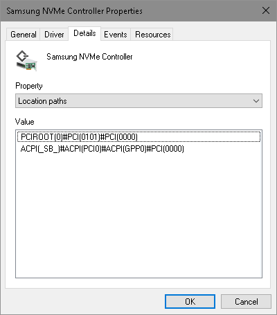

patricia2626 Posted September 3, 2017 Author Share Posted September 3, 2017 is this one https://imgur.com/sSL9qSQi got that from the person who use the same one https://www.tonycrapx86.com/threads/guide-hackrnvmefamily-co-existence-with-ionvmefamily-using-class-code-spoof.210316/page-27 Link to comment Share on other sites More sharing options...
Moderators Jake Lo Posted September 3, 2017 Moderators Share Posted September 3, 2017 it depends on the system where the location is, not the drive brand. did you find something similar as the user, please post screenshot. Use the "More Reply Option" on the lower right to attach rather than using external link Link to comment Share on other sites More sharing options...
patricia2626 Posted September 3, 2017 Author Share Posted September 3, 2017 Link to comment Share on other sites More sharing options...
patricia2626 Posted September 3, 2017 Author Share Posted September 3, 2017 _SB.PCI0.GPP0 is the parent node of your SSD.The SSD itself is without an identity (you have to add one at _ADR=0) Link to comment Share on other sites More sharing options...

Moderators Jake Lo Posted September 4, 2017 Moderators Share Posted September 4, 2017 Which OS X are you installing? Did you create the spoof HackrNVMeFamily.kext for that version of OS X? add the kext to /EFI/Clover/kexts/Other add the SSDT_NVMe-Pcc.aml to /EFI/Clover/ACPI/patched add the the SSDT_NVMe-Pcc.aml to Config.plist under SSDT sortedOrder Post your Config.plist file if you need help Link to comment Share on other sites More sharing options...

Moderators Jake Lo Posted September 4, 2017 Moderators Share Posted September 4, 2017 Here's the ssdt and kext built for 10.12.6 If the USB installer you had earlier is 10.12.6, no need to rebuild. add the kext to /EFI/Clover/kexts/Other add the SSDT_NVMe-Pcc.aml to /EFI/Clover/ACPI/patched add the the SSDT_NVMe-Pcc.aml to /EFI/Clover/Config.plist under SSDT sortedOrder I don't know how to build one for AMD system. NVMe_960Evo.zip Link to comment Share on other sites More sharing options...
