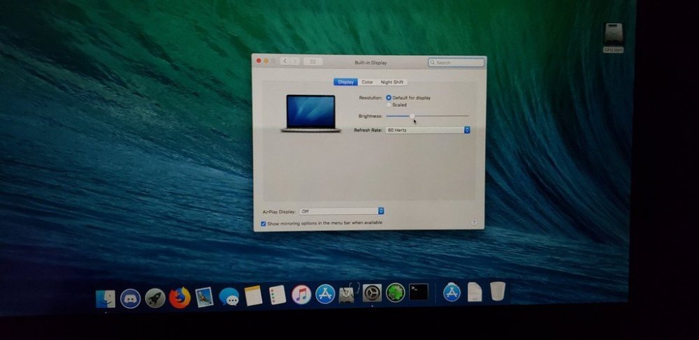

FoxND001 Posted August 23, 2018 Author Share Posted August 23, 2018 @Jake Lo, that is interesting. The 5414 has an HDMI port and a VGA port - no DisplayPort at all. I suspect that this is partly due to Dell's tendency to like to re-use motherboard designs between systems. I'm willing to bet that the 5414 motherboard could have had a DisplayPort, but that feature was not physically implemented in the 5414. However, this is just an educated guess. Regardless, more testing! I tried the VGA port today. This went very well - the external monitor came on almost immediately when connected via VGA cable; more importantly, the Built-In display stayed on too. I was able to do mirrored screens from built-in, mirrored screens from external, and separate displays. Dual screens with VGA functions flawlessly on this machine - I'm calling that a win! I'm attaching a new IOReg that was captured while the VGA cable was connected and the screens were set to mirror from the built-in display. I hope you find this useful. Now for the problem encountered. Sleep is acting differently than it did previously. In earlier testing, I could sleep the system if I manually selected "Sleep" from the apple menu, and I could successfully wake the system and use it; closing the lid simply made the screen turn black, and the screen would not come back on until you rebooted. That's the old behavior. This behavior has changed. Now I can sleep the system anytime by choosing "Sleep" from the apple menu or by closing the lid. This works consistently, and I get the "breathing" power light after about 20-25 seconds. So far, so good. However... When I then try to wake-up the system by pressing the power button or by opening the lid, the system does wake up and the screen lights up, and I am even able to type a few characters. After that, the system grinds to a halt and becomes unresponsive. The symptoms are after the system "wakes-up": 1) sluggish performance 2) keyboard becoming unresponsive 3) In the WiFi menu, entries appear very wrong. If you click the WiFi icon, you'll see entries like this: kAirPortStatusScanningKey kAirPortTurnOffKey kAirPortOtherKey kAirPortCreateNetworkKey kAirPortOpenNetworkPrefsKey 4) the mouse becomes unresponsive after a few clicks 5) sometimes the background of the desktop disappears and turns black 6) eventually, the system completely locks up and becomes unresponsive I'm attaching the current debug file. I can't get one after resuming from sleep , as the system crashes shortly after wake-up, so this debug file is taken immediately before sleep. Hopefully this will help. Any ideas or instruction on how I should proceed? Let me know and I'll follow your instruction. Latitude 5414 Rugged - Built-In and VGA External Mirrored.ioreg.zip debug_7772.zip Link to comment Share on other sites More sharing options...

FoxND001 Posted August 24, 2018 Author Share Posted August 24, 2018 @Jake Lo, here are the results of testing for today: I applied your modified config.plist and then rebuilt permissions - no problems there that I could tell. I then tested the external displays. External displays performed exactly the same as before, with no changes that I could find. HDMI out still required closing and opening the lid to show on the built-in and external displays. VGA out performed flawlessly. I then decided to hook-up both two external displays, one via HDMI and one via VGA, to see what would happen. The results were very good - all three screens (Built-in, HDMI, VGA) worked. In this configuration, I was able to select up to 1920x1080 for the Built-In and HDMI screens; for the VGA, I was only able to select up to 1360x768. Still, to have two external screens on one laptop is pretty nice, so I'll take that as a win. For completeness sake, I captured the data - I have IOReg dumps for when the HDMI monitor is connected, for when the VGA monitor is connected, and for when both are connected at the same time. The dumps are big, so I'll attach them individually in follow-up posts. Question - do you want to try forcing the HDMI port to be seen as HDMI instead of DisplayPort or VGA? I could then capture the data just like I did above. No need to do it if you don't think it's worth the time, but I thought I'd offer to do the testing if you think it's worth it. On to audio. There was a change with audio output. HDMI audio out stopped functioning, and the HDMI output device no longer shows up in System Preferences -> Audio -> Output when you connect the HDMI cable. Previously, a new audio device would show up, but it's definitely gone now. Audio input was completely unaffected, and functioned as expected. There was no change in the behavior for Sleep - it still hangs when the system wakes up. However, I did find a bit more information. When I tried to open iTerm2 after the system wakes up, I got an error that basically said "I can't write to this temporary file on your disk". I wasn't quick enough to capture the exact verbiage, but that was the gist of the error. Since I am currently booting from the SD Card, I'm wondering if the problem may be that the bus that the SD Card reader is attached to may not be responding correctly after resume. I don't have much to base this on, but it makes sense from observation - the system recovers from sleep by what is in RAM, but can't access it's disk, so it grinds to a halt. Given the above with Sleep, I'm going to hunt down a spare SSD or SSHD and swap out the main system drive (I don't want to loose the other OS on the main system drive just yet). Once I swap out the drive, I'll re-install HS based on what has been done thus far, and then re-test everything. This will take some time, but I'll reply here once I have more data from testing without booting from the SD Card. That's it for today. Do you have any other suggestions for me or configs/patches you would like me to try? Please let me know and I'll get the testing done. Also, I'll attach the debug for today's efforts; the IOReg files for the various monitor configurations are coming shortly Thanks again for all your help! This really would not be possible without it, and I (and I'm sure countless others) are very grateful. debug_30967.zip Link to comment Share on other sites More sharing options...
