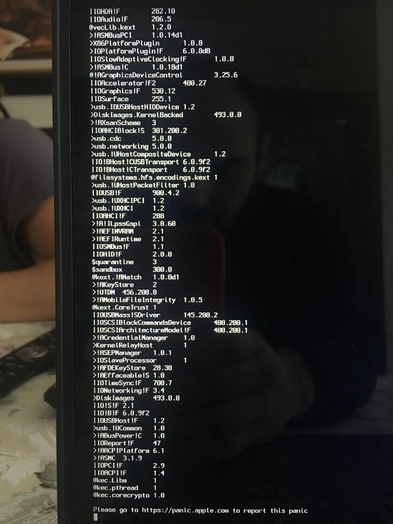

bbuontempo Posted November 18, 2018 Author Share Posted November 18, 2018 Thanks for the reply, Here is the clover folder and ill upload the photo of the panic right after. CLOVER.zip 1 Link to comment Share on other sites More sharing options...
bbuontempo Posted November 18, 2018 Author Share Posted November 18, 2018 Link to comment Share on other sites More sharing options...

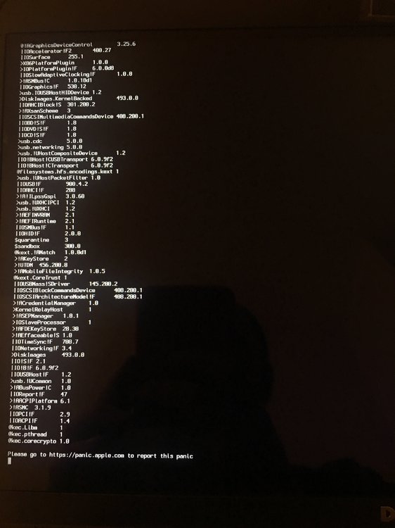

bbuontempo Posted November 21, 2018 Author Share Posted November 21, 2018 I basically created a new bootable USB with OS Mojave and I’m trying to install it on a OS high Sierra partitioned ssd. This is the panic I get Link to comment Share on other sites More sharing options...
Moderators Jake Lo Posted November 21, 2018 Moderators Share Posted November 21, 2018 Clover setting: Install for UEFI booting only Install Clover in the ESP Drivers64UEFI\DataHubDxe-64 Drivers64UEFI\FSInject-64 Drivers64UEFI\SMCHelper-64 Drivers64UEFI\ApfsDriverLoader-64 Drivers64UEFI\AptioMemoryFix-64 Drivers64UEFI\PartitionDxe-64 Install Clover Preference Pane Add to Drivers64UEFI\HFSPlus.efi (Not included in Clover installer) Did you try replacing the file and folders linked? Config.plist, ACPI and kexts folder 1 Link to comment Share on other sites More sharing options...
bbuontempo Posted November 21, 2018 Author Share Posted November 21, 2018 Yup, I installed clover with those exact setting and I used the folder you posted above. It’s weird tho because I get to the install screen and It installs but when there’s about 2 minutes left the computer performs a restart and then I get the panic. Can it be I need to reformat the ssd and then install? Link to comment Share on other sites More sharing options...
Moderators Jake Lo Posted November 21, 2018 Moderators Share Posted November 21, 2018 You need to reboot with the USB installer and then select "Install macOS from <name of your SSD>", take a couple of reboot before installation completes. Check Clover option to see if FixHeaders is enabled as well Link to comment Share on other sites More sharing options...
