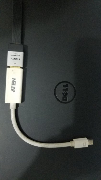

Moderators Jake Lo Posted July 28, 2019 Moderators Share Posted July 28, 2019 Is it a miniDP (PC) to HDMI or DP(Samsung TV) Link to comment Share on other sites More sharing options...
aufannada Posted July 28, 2019 Author Share Posted July 28, 2019 Ya, a miniDP to HDMI to Samsung TV Link to comment Share on other sites More sharing options...

aufannada Posted July 28, 2019 Author Share Posted July 28, 2019 Okay Jake, now MiniDP to HDMI to Samsung TV can already make a sound. Same as when using HDMI to Samsung TV directly. Thank you very much. If I may know, what is added or changed from the config.plist above? Link to comment Share on other sites More sharing options...
Moderators Jake Lo Posted July 28, 2019 Moderators Share Posted July 28, 2019 HDMI is on port 105, DP is on port 204 I just patched port 204 to be HDMI If you want to use miniDP to DP in the future, revert back to the old Config. Just compare the changes under Devices/Properties. 1 Link to comment Share on other sites More sharing options...
