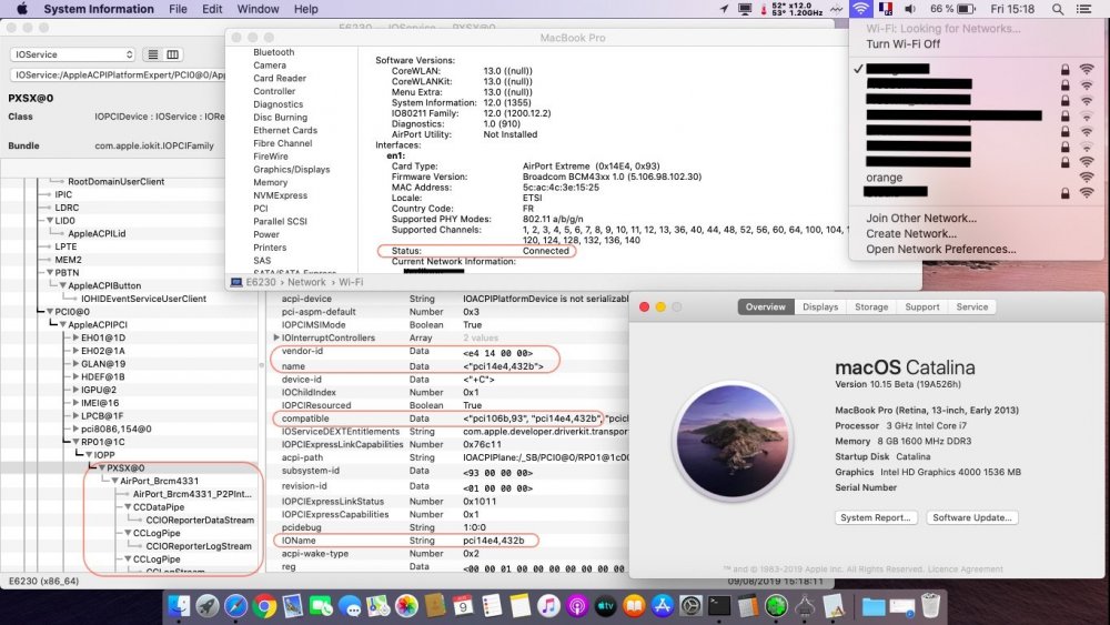

Administrators Hervé Posted August 9, 2019 Administrators Share Posted August 9, 2019 It's not dropped; still covered by the AirPortBrcm4331 kext. Link to comment Share on other sites More sharing options...

Administrators Hervé Posted August 9, 2019 Administrators Share Posted August 9, 2019 DW1510 works OOB; you must have done something wrong... I took my Apple BCM94360CD out of my Latitude E6230 and connected a DW1510 with a single antenna. Here is how it goes under Catalina Beta 5: Ookla results are as follows (only 1 x antenna connected, so reduced rates/performance): Link to comment Share on other sites More sharing options...
