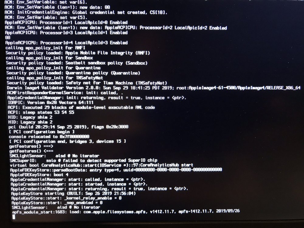

doctorultra Posted October 10, 2019 Share Posted October 10, 2019 Hi, I´ve started the update of catalina from mojave on my 7470, but the update hang on the current screen, do sth know what can it be? Link to comment Share on other sites More sharing options...

Moderators Jake Lo Posted October 10, 2019 Moderators Share Posted October 10, 2019 That's why I said to add it. Click on the + sign on the right and then manually enter in the info as in the screenshot Link to comment Share on other sites More sharing options...
Moderators Jake Lo Posted October 10, 2019 Moderators Share Posted October 10, 2019 Doesn't matter, all Dell requires this patch for Catalina. Won't be an issue for Mojave or HS with that added patch either. If you search your raw DSDT for Embedded Controller, what ever name it is, rename it to EC Example, some system has H_EC, others has EC0, for Dell it's named ECDV, they all will have to be rename to EC like on a real Mac. Link to comment Share on other sites More sharing options...
doctorultra Posted October 10, 2019 Author Share Posted October 10, 2019 when i input it manually like on the screenshot then I got an acpi error? Link to comment Share on other sites More sharing options...
Moderators Jake Lo Posted October 10, 2019 Moderators Share Posted October 10, 2019 Post the error screenshot and the Config file. Make sure to boot with verbose + debug 0x100 mode Link to comment Share on other sites More sharing options...
doctorultra Posted October 10, 2019 Author Share Posted October 10, 2019 Now it works, i used your pilst File. thnks Link to comment Share on other sites More sharing options...
