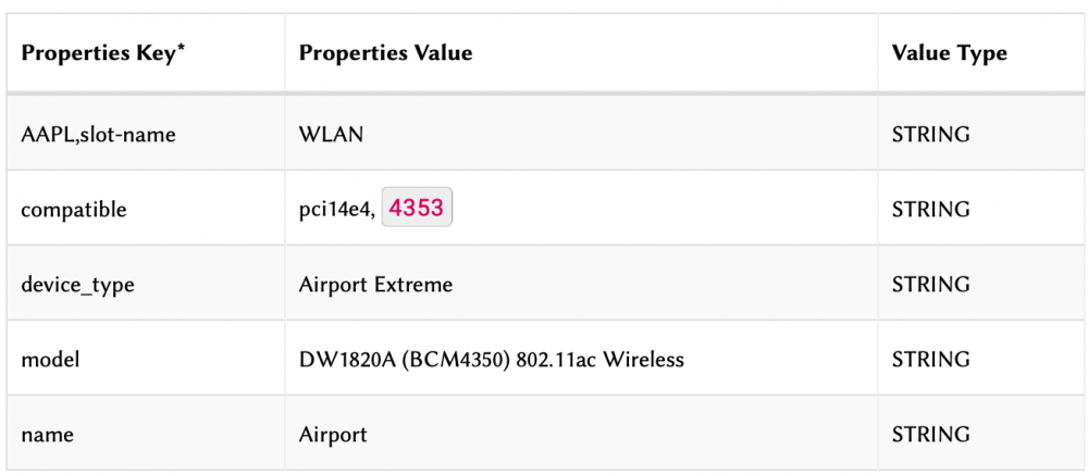

ahalol Posted November 17, 2019 Author Share Posted November 17, 2019 I can confirm HDMI works but I don't have a DP device to test. For DW1820A, I used AirportBrcmFixup_v2.0.4.kext; added "brcmfx-country=#a" under config.plist - boot; and in config.plist - devices - properties: PciRoot(0x0)/Pci(0x1c,0x0)/Pci(0x0,0x0) -> attached photo. Reference (in Chinese): https://blog.daliansky.net/DW1820A_BCM94350ZAE-driver-inserts-the-correct-posture.html Link to comment Share on other sites More sharing options...
Moderators Jake Lo Posted November 17, 2019 Moderators Share Posted November 17, 2019 What's the exact model of your DW1820a? From your Ioreg, the subsystem ID = 106b, 0022 Link to comment Share on other sites More sharing options...
ahalol Posted November 17, 2019 Author Share Posted November 17, 2019 On the chip it says: CN-096JNT BCM94356ZEPA50DX_2 Link to comment Share on other sites More sharing options...
