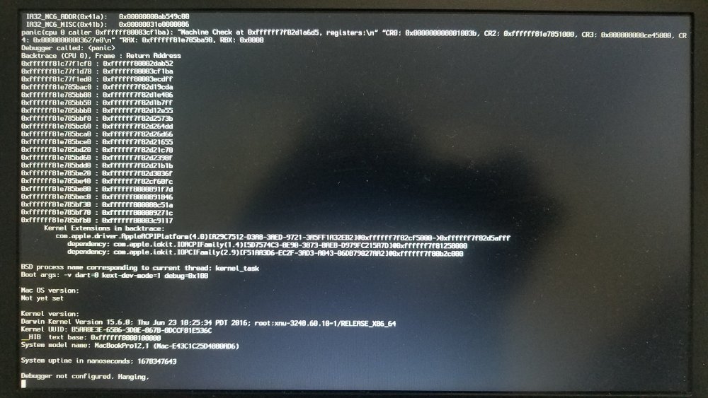

aufannada Posted June 11, 2019 Author Share Posted June 11, 2019 Yes, I already used EFI El Capitan that you sent both on the FD Installer and on the SSD that has El Capitan installed. And both of them can't boot normally to the desktop. Even if I use boot arg -igfxvesa and / or -no_compat_check. The result is like the picture I sent earlier. Why do I use the current EFI, because it can install and enter the SSD installed El Capitan. But the problem are : 1. I have to use boot arg -igfxvesa to boot until it enters the desktop. 2. The display is still 4MB after enter the desktop. Maybe this can help a little : When I execute ssdtPRGen.sh from terminal to generated SSDT.aml ssdtPRGen.sh v0.9 Copyright (c) 2011-2012 by † RevoGirl v6.6 Copyright (c) 2013 by † Jeroen v21.5 Copyright (c) 2013-2019 by Pike R. Alpha ----------------------------------------------------------- Bugs > https://github.com/Piker-Alpha/ssdtPRGen.sh/issues < /Users/aufannada/Downloads/MASTERS/MAC/SYSTEMS/INSTALLER DELL LATITUDE E7270/TOOLS/ssdtPRGen.sh: line 3877: /Users/aufannada/Library/ssdtPRGen/Data/Versions.cfg: No such file or directory System information: Mac OS X 10.11.6 (15G31) Brandstring: "Intel(R) Core(TM) i7-6600U CPU @ 2.60GHz" Notice: Downloading extractACPITables.zip ... Notice: Downloading User Defined.cfg ... Notice: Downloading Sandy Bridge.cfg ... Notice: Downloading Ivy Bridge.cfg ... Notice: Downloading Haswell.cfg ... Notice: Downloading Broadwell.cfg ... Notice: Downloading Skylake.cfg ... Version: models.cfg v171 / Skylake.cfg v195 Scope (_PR_) {222 bytes} with ACPI Processor declarations found in DSDT (ACPI 1.0 compliant) Notice: Downloading Restrictions.cfg ... Notice: The LFM frequency in Mac-E43C1C25D4880AD6.plist is set to 1300 MHz! This restriction can be lifted with help of freqVectorsEdit.sh from: https://github.com/Piker-Alpha/freqVectorsEdit.sh Generating ssdt.dsl for a 'MacBookPro12,1' with board-id [Mac-E43C1C25D4880AD6] Skylake Core i7-6600U processor [0x406E3] setup [0x0705] With a maximum TDP of 15 Watt, as specified by Intel Number logical CPU's: 4 (Core Frequency: 2600 MHz) Number of Turbo States: 8 (2700-3400 MHz) Number of P-States: 30 (500-3400 MHz) Adjusting C-States for detected (mobile) processor Injected C-States for CPU0 (C1,C3,C6,C7) Injected C-States for CPU1 (C1,C2,C3,C6,C7) Warning: 'cpu-type' may be set improperly (0x0705 instead of 0x0905) - Clover users should read https://clover-wiki.zetam.org/Configuration/CPU#cpu_type Error: board-id [Mac-E43C1C25D4880AD6] not supported by Skylake – check SMBIOS data / use the -target option It says that : 1. 'cpu-type' may be set improperly (0x0705 instead of 0x0905) 2. Error: board-id [Mac-E43C1C25D4880AD6] not supported by Skylake In Clover Configurator - SMBIOS, Mac-E43C1C25D4880AD6 is MacBookPro12,1 - MacBook Pro (13-inch, Retina, Early 2015) Intel Core i5-5257U @ 2.70 GHz. 5257 is not Skylake Link to comment Share on other sites More sharing options...
Moderators Jake Lo Posted June 11, 2019 Moderators Share Posted June 11, 2019 Ok, try this, replace into /EFI/Clover. Files patched from your Origin folder. You can continue using the kexts folders as is, but maybe remove NoTouchID.kext. Don't need to generate SSDT.aml, Clover Config has pluginType enable which does the same thing. E7270_aufannada.zip 1 Link to comment Share on other sites More sharing options...
aufannada Posted June 11, 2019 Author Share Posted June 11, 2019 Oh God, I'm very grateful to you Jake. Now it works and booting is very fast entering the desktop. Just a few seconds. The display is now full to 1536MB. I am very happy. Thank you very much, Jake. You are the best. Link to comment Share on other sites More sharing options...
