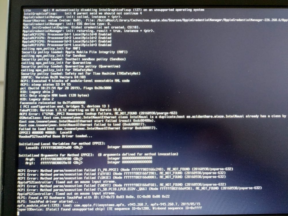

Luiz Felpera Posted February 28, 2020 Author Share Posted February 28, 2020 I saw this post but was scared to replace due its to Catalina. Well, did as you said, replaced files on my Kext/Other and ACPI but now it wont boot anymore, stucked on attached error, even if disabling Inject Intel. Had to boot with USB stick with old kexts. Don't know if it has to do with this error, but look at this screenshot, "Kilu: disabling IntelGraphicsFix on unsupported OS" Link to comment Share on other sites More sharing options...

Moderators Jake Lo Posted February 29, 2020 Moderators Share Posted February 29, 2020 Clover folder found in the debug shows a really old bootpack and static DSDT that's causing your issue. You're not using the files I've linked above on post 2. Perhaps you're booting from the USB and it's pulling files from your USB installer.... Compare the files I have linked in post 2 and the Clover folder you attached with the debug, see the differences?? Link to comment Share on other sites More sharing options...
