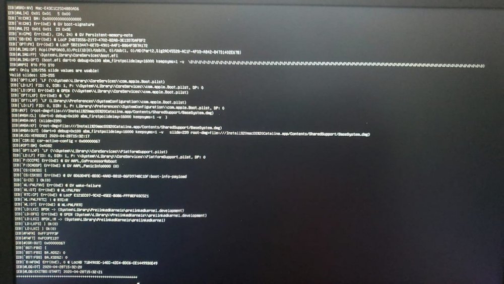

Atzin83 Posted April 28, 2020 Share Posted April 28, 2020 i try to make a clean install following exactly this tuto whit clover 2.5k_r5103, and my first attempt whit everything normal just keep on the apple logo, in my second attemp whit -v just freeze after a few seconds, image attach. any sugestion? my specs: Dell e7450, 12 gb RAM, SSD 240, Core I5 5300u Intel HD 5500 Graphics Link to comment Share on other sites More sharing options...
Moderators Jake Lo Posted April 28, 2020 Moderators Share Posted April 28, 2020 For catalina 10.15.4, you need a minimum of Clover v5107 for this model. Link to comment Share on other sites More sharing options...
Atzin83 Posted April 28, 2020 Author Share Posted April 28, 2020 Thanks a lot, everything runing ok, just go to buy dw1560 and enjoy my hackintosh...regards Link to comment Share on other sites More sharing options...
