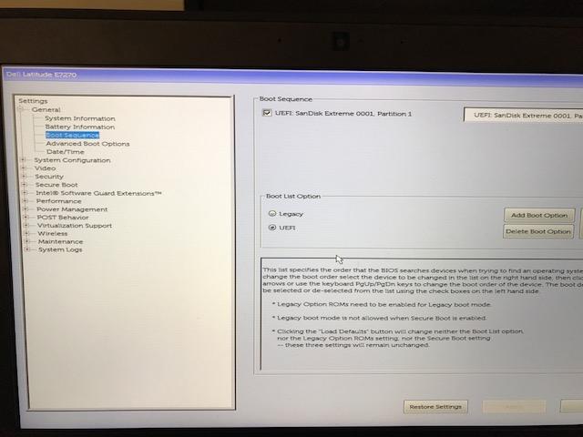

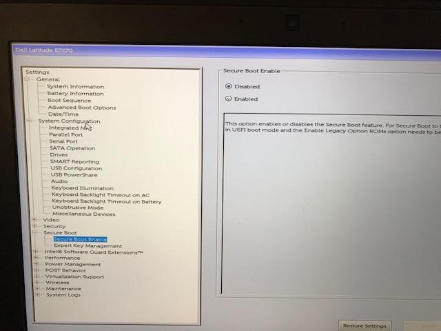

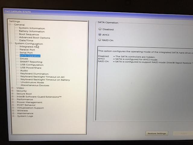

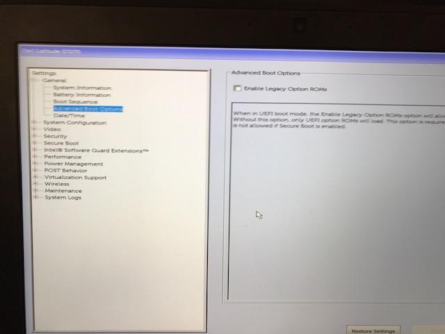

tricade Posted June 1, 2017 Author Share Posted June 1, 2017 Please see the screenshots - Bios Settings I added a USB HDD for the installation - the USB Stick is Clover with MacOS Sierra install. So in total 3 drives. USB Stick installation - USB HDD spare drive and a NVME driver. Still I cant see any drives... thats so wired I tried to use DiskMakerX and your method to create a OSX Installation. Link to comment Share on other sites More sharing options...
Moderators Jake Lo Posted June 1, 2017 Moderators Share Posted June 1, 2017 Make sure you have HFSPlus.efi in /EfI/Clover/driver64UEFI Link to comment Share on other sites More sharing options...

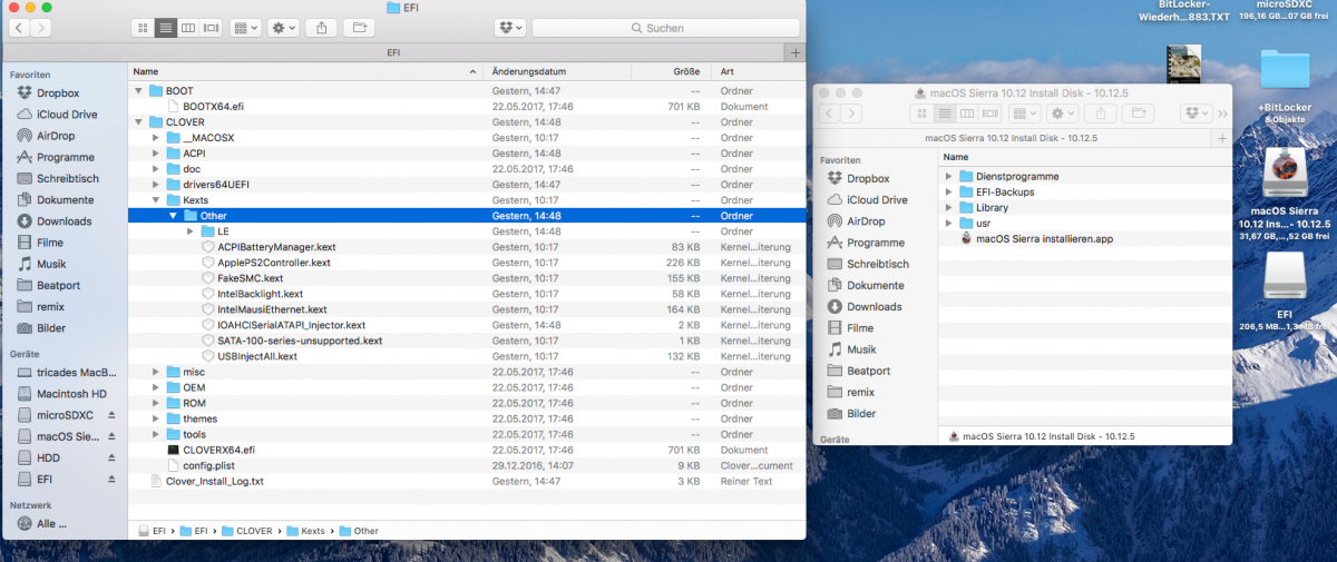

tricade Posted June 1, 2017 Author Share Posted June 1, 2017 Clover does not copy this file to /EfI/Clover/driver64UEFI ....I found a copy here https://github.com/JrCs/CloverGrowerPro/tree/master/Files/HFSPlus/X64 Is that the correct one? Link to comment Share on other sites More sharing options...
Moderators Jake Lo Posted June 1, 2017 Moderators Share Posted June 1, 2017 Yes, that should work. Link to comment Share on other sites More sharing options...

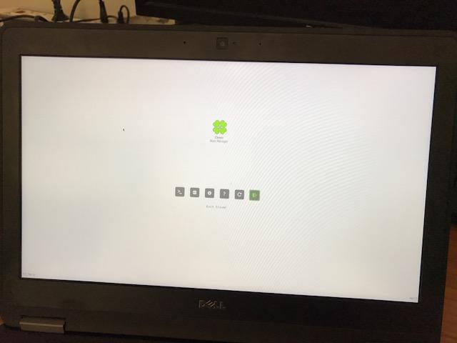

tricade Posted June 1, 2017 Author Share Posted June 1, 2017 Alright iam able now to start the installtion ! I really wonder why this EFI driver was not added by clover.... anyway this is what I see now Link to comment Share on other sites More sharing options...
Moderators Jake Lo Posted June 1, 2017 Moderators Share Posted June 1, 2017 Make sure to use latest boot files from here under 10.12.4 update Link to comment Share on other sites More sharing options...

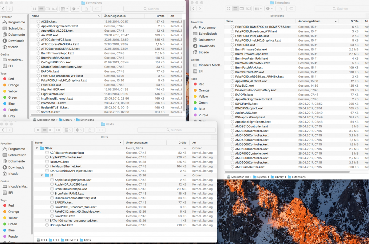

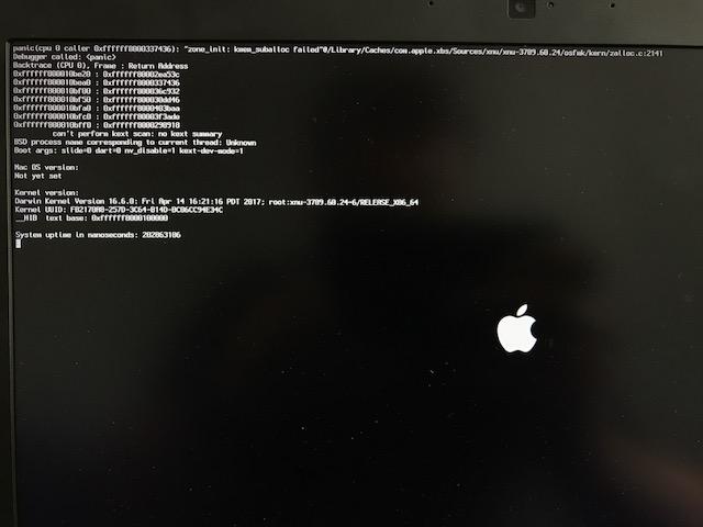

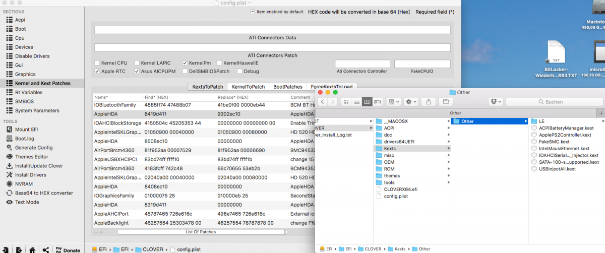

tricade Posted June 1, 2017 Author Share Posted June 1, 2017 I did used "https://osxlatitude.com/index.php?app=core&module=attach§ion=attach&attach_id=13483" for the newest Bios + OS.Copied those files in the existing folder on the EFI drive (replaced those) you can see it in the screenshot in my first postEDIT: Fixed belive me or not... I moved the RAM from Slot B to A and I can start the install now. May you can add this to your guide! Link to comment Share on other sites More sharing options...

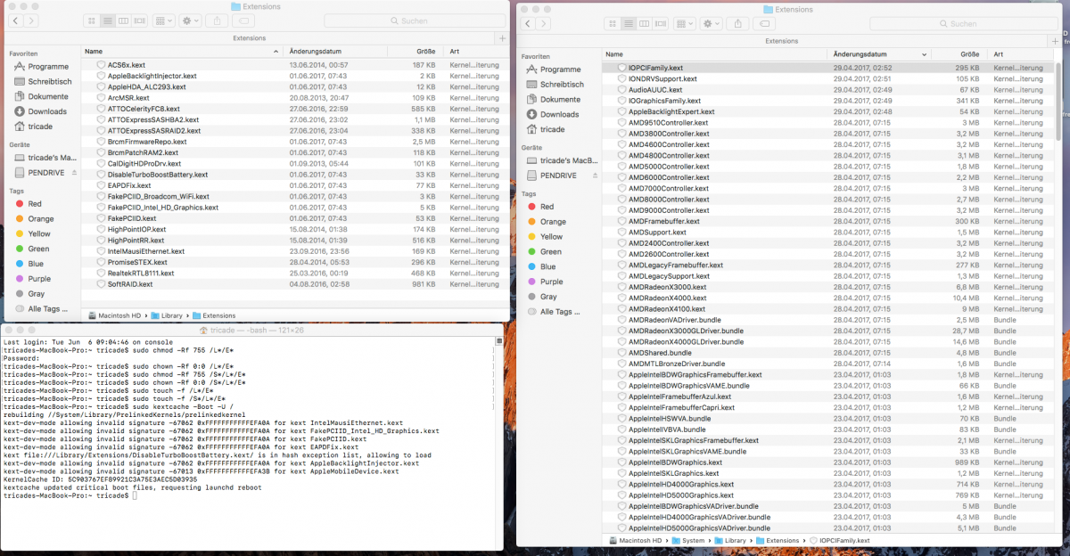

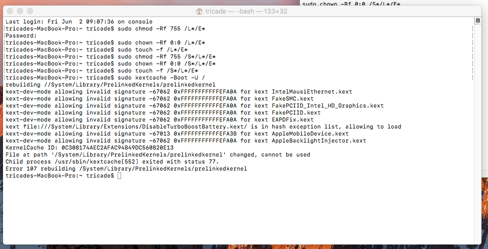

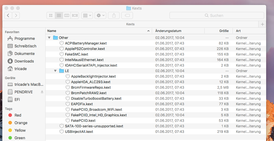

tricade Posted June 1, 2017 Author Share Posted June 1, 2017 After I updated the FAKE SMC driver iam able to access the Internet with a cable thats OK For Wlan I can buy a USB Wlan card that is supported. Only one think is missing thats the sound :/ All I know is that this Laptop has a ALC3235 Chip from Realtec inside. Anyone has an idea? And yes I used "https://osxlatitude.com/index.php?app=core&module=attach§ion=attach&attach_id=13483" No success Link to comment Share on other sites More sharing options...
