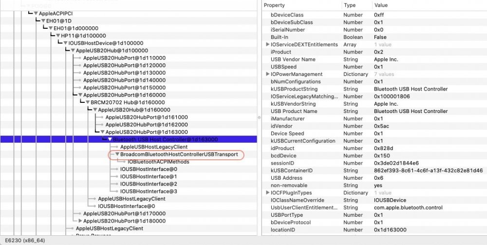

Administrators Hervé Posted July 31, 2020 Administrators Share Posted July 31, 2020 No, Bluetooth chipset BRCM20702 is supported OOB. Do you have any other built-in BT device in that computer? If so, disable Bluetooth in BIOS. Your screenshot does not show any transport controller kext loaded so there's clearly something wrong with the module or, maybe, your OC configuration (can't help you with that)... Did you connect your module to an internal USB port? That's obviously required. Here's what you would normally expect to see in IOReg: I've checked Catalina 10.15.6's BroadcomBluetoothHostControllerUSBTransport kext and it does cover your device (0x821f, i.e. 33311 in decimal) so all is Ok on that side. Could you please post a zipped copy of a saved output? Link to comment Share on other sites More sharing options...

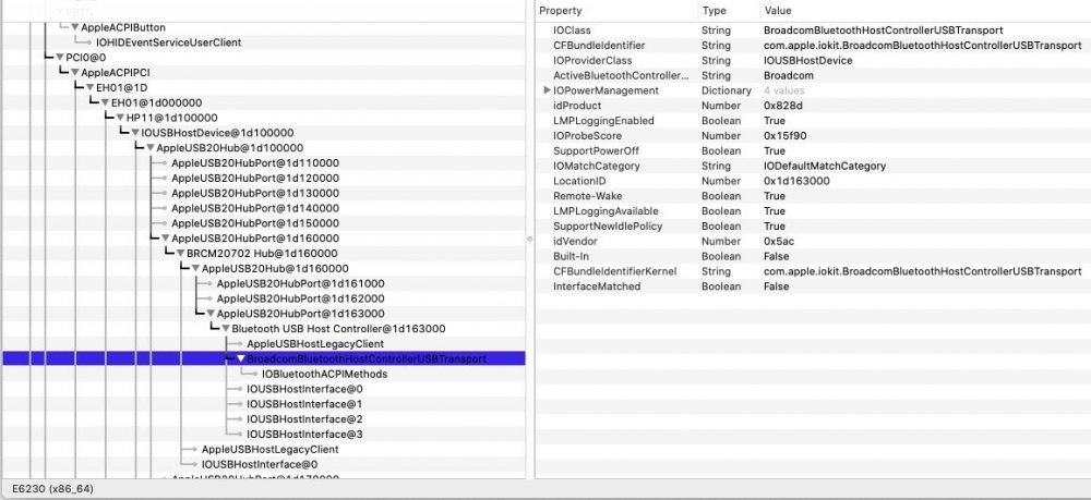

Administrators Hervé Posted July 31, 2020 Administrators Share Posted July 31, 2020 Everything looks good to me now in that IOReg of yours: Can't see why you'd have Bluetooth issues. Try and disconnect that wireless USB adapter just in case it interferes... Link to comment Share on other sites More sharing options...
